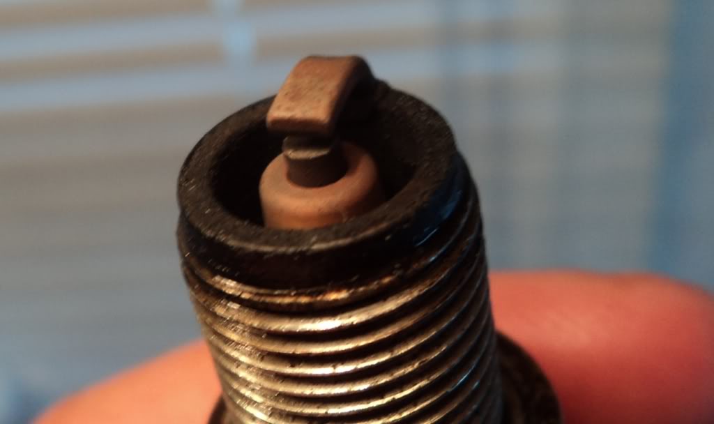

How do my plugs look? Plug reading experts needed..
Slowmoe
Ok so I ran wot till I hit my max speed and then pulled the key, here is a pic of one of the plugs. To me it looks lean but I'm not really good at reading plugs so any help will be appreciated.
Looks fine to me... but on a 2-stroke with some miles on it... I personally like to see them a little darker.
What oil are you burning?
You need to turn the plug in the picture. How far down the ground is the tan color? If level with the tip of the + side then your good. If higher your a touch cold and close the gap .010 Most of the time it is better to go to a hotter plug and open the gap. Much harder to balance a cold plug up than down.
