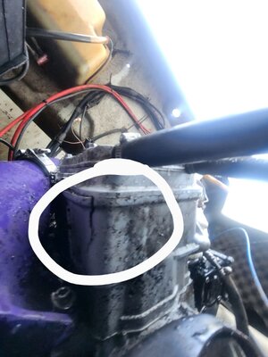

So, yeah...I got ripped off. Bought a 97 challenger that the guy swore up and down that had a rebuilt engine in it...well...a giant crack in the upper must have been installed when they did it (see pic). SO I am in a conundrum. will any 787 mate up with the drive components of this boat? I found a 787 but it is not the same year. it looks identical, but I'm unsure about drive and engine working together.

If you have not sprung for an entire engine, consider replacing the cylinders and pistons. Was about $500 for a set when I did it 3 years ago. Prices seem much higher now though. If you go with rebuilt you will have to find a used uncracked cylinder to get full core refunded.
