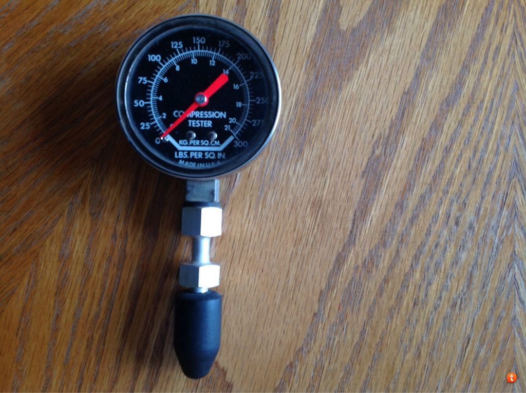

Any comment on this compression gauge? I've had it for ages but never used it. It was a friends fathers, I got it when he passed away fifteen years ago. It's got the shrader valve at the bottom end where the rubber tip is. Do most compression gauges thread into the spark plug hole or do they have the rubber cone like this one? I'll try it out when I get my ski out of storage. It runs great but the motor is seventeen years old with no rebuild as far as I know.
I have an old push in gauge like that, and it works well. The only drawback is... you normally need a helper, since you may need 2 hands to hold enough pressure on the tool to keep it from leaking.
I also have a push-in type gauge, I've had it for over 30 years, I replaced the sharder valve in it about 5 years ago. The gauge is very accurate and still works well, however, it works fine for 717's but with a 787 (the engine being slanted) there's not enough clearance between the bulkhead and the engine to use the gauge. I'll bet you're gonna have the same problem with your GTX.
