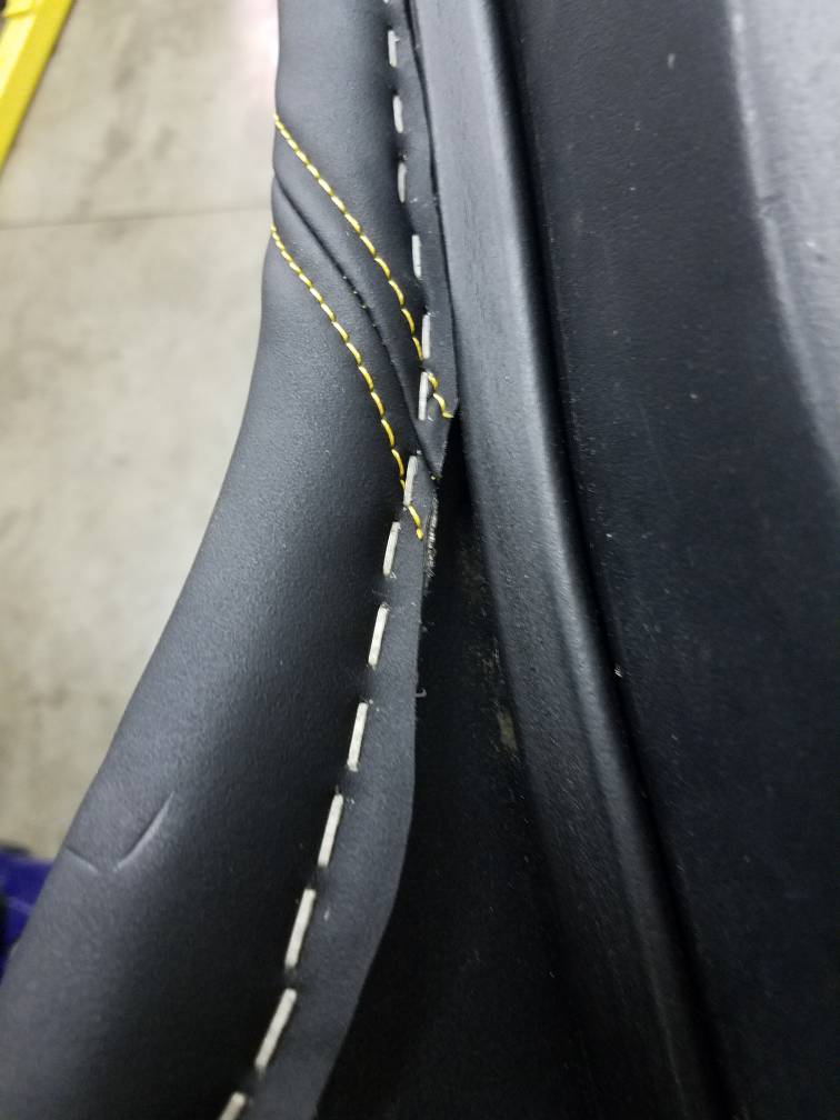

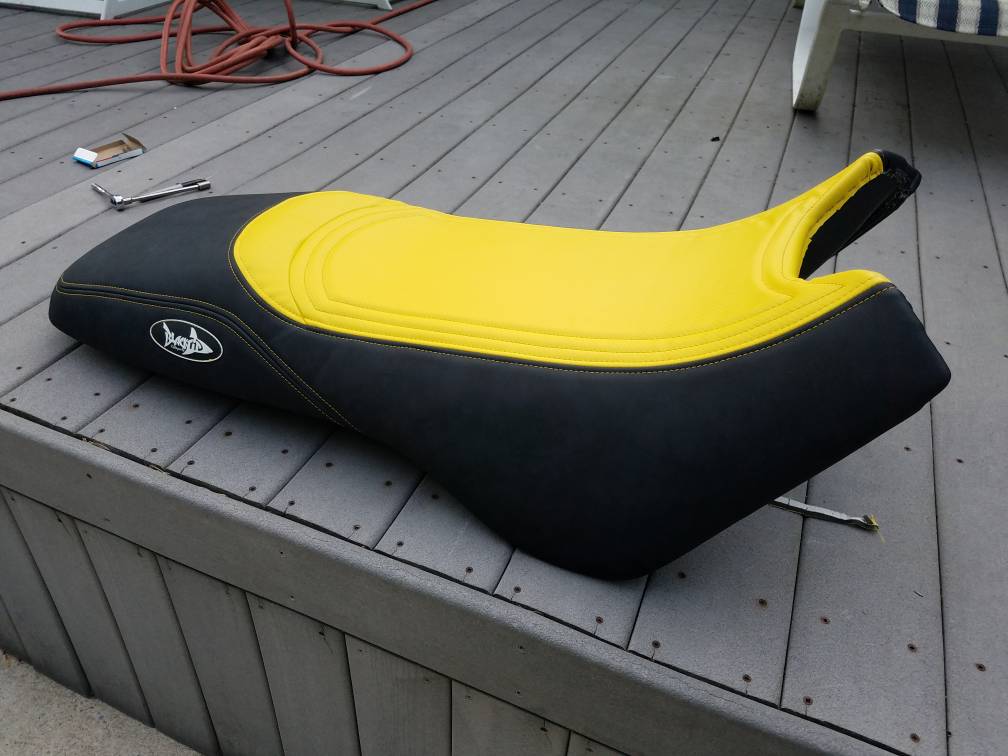

This was one I did a few weeks back.

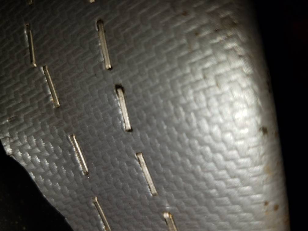

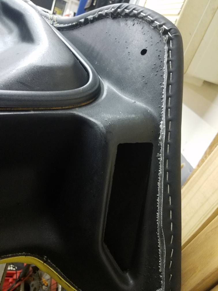

I position the cover where i "think" I want it. Staple in far (look at my seat pics above, see the old staple holes in far) to start with. a few in the back and few in the front, stretch the sides tight and toss a few in there. Stretch, manipulate, what ever a staple here a staple there until you see where it's gonna wrinkle, bolster or fold. Then you need to adjust your technique. Measure the logos from the bottom of them to the seat pan on both sides, make sure they're the same distance. Once you have it where you can work with it, staple in the original location at the edge of the pan. Always working, stretching, pulling etc.... Then trim around the edge to get rid of the excess material. That seat cover took me about 1.5 hours start to finish.

Wow that seat came out incredible. Where did you start in order to not have the bubble?
I didn't realize you had already answered my question. Thank you so much. That is very helpful.
