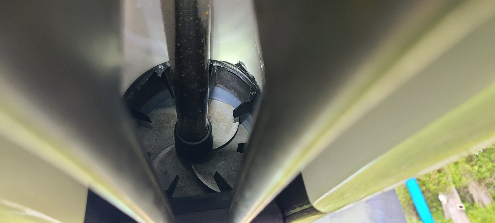

Jet pump. Most problems with the boat not reaching speed but RPM’s going above idle comes from the jet pump being out of spec.
For starters,
Crawl under the boat when in the trailer if you can and take some pics of up under the grate in the rear looking back.
Post them here.
Like this....
