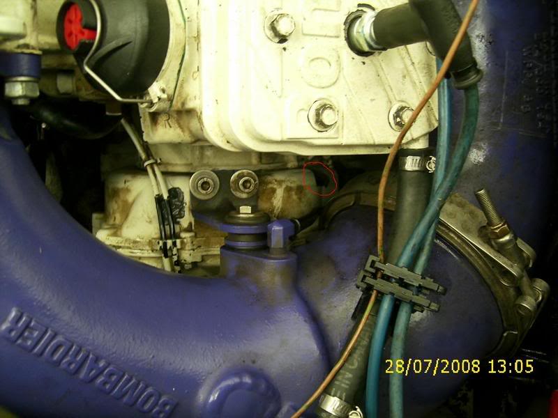

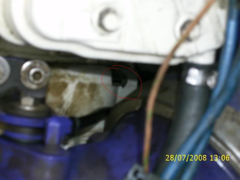

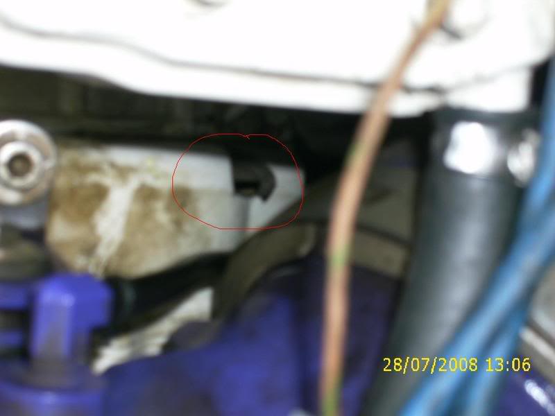

new whole!!
so the cylinder was fixed...also change the oil pumb...and sealed a little whole that was on the top of the magneto.
this week end tried the boat...engine ran a-1!!
but take alook at that!!!!
what the /%/$%/%?/?% caused that???
a whole in the magneto?? is that what its called??
help me..NOW!!!lol
WOW...probably was cracked, then pipe vibration got best of it. Thing is, if that piece fell inside, eventually, will get caught up in magneto/stator assy and ground it out, pop'n fuse/s. Up to you, can silicone it up, and keep goin...:cheers:
