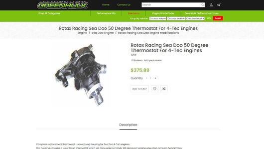

Just like Digdog said, that actually happened to my ski, the one in the picture......where I rode on the river for a short time, then all of a sudden it went into overheat alarm. Shut the ski off, opened the back seat, and saw all the coolant steaming and coating the entire back half of the inside hull, the bottom of the hull, and all rear engine parts. I let it sit for a while to cool, but limped it off the river, got it back home, and in theory suspected either a stuck thermostat, or a blown head gasket. I figured the head gasket was fine because I let it sit on the river for half an hour to cool, enough to crank it back up......well it did crank back up and actually had some pull........so I suspected the thermostat. I since pulled the head and replaced the head gasket anyway, with a new OEM gasket. Also replaced the coolant pump assembly with a complete new unit, but I ordered the 160 degree pump from Greenhulk. The thing cost $375 but I have since ran the ski at 8800 rpm @ WOT on a custom Maptune several times and everything is fine.....no leaks, no blowouts, and the temps seem to be within operating range. I also have since replaced the coolant temp sensor and the EGT sensor. The coolant doesn't dip at all in the coolant bottle. The stuck thermostat is why all my coolant blew out, and it blew out thru the coolant bottle vent hose.

Yep that is exactly what mine was doing........I would fill the coolant back up but by morning it would all leak out again. I would be willing to bet your dealing with a stuck thermostat.......your ski has all the classic signs, especially from the results of the leak test, and what the coolant is doing now. The thermostat is blocking the coolant to the ride plate, so the coolant that is stuck in the cylinder jacket and up to the thermostat is boiling out. If you can afford it, man I would seriously consider just biting the bullet and ordering the 50 degree thermostat pump from Greenhulk store......I can tell you I been running the crap out of my ski like i stole it, and I know I am pushing the limits of the coolant temps, but it handles it very well........very worthy investment, and gives peace of mind that you won't break down miles from the dock.
