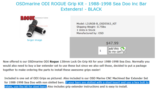

Looking to get some new handlebar grips for both skis (97 SPX and 97 GTS) - I'm liking the look of the ODI Rogue from OSD. It is my understanding that I will need bar extenders and the OSD kits come with the appropriate extenders. However, there's a few "types" of kits listed on OSD and I'm not sure which one to pick. They all have the same stock image so I can't really tell by looking at the pictures which one will fit my handlebars.

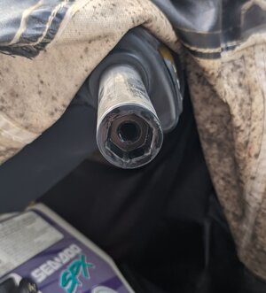

The listing for my year range (first image) states "If your bars are slotted with a steel insert and use a hex bolt to retain, use the kit for steel bars." - I'm not entirely sure what "slotted" refers to in this context or if mine are "slotted" or not. Mine are definitely made of steel (not sure what other materials are possible here tbh), and there was a 10mm hex bolt holding them onto the ends. Does that mean I need the other one listed? The one for "steel bars"?
OSD listing
My bars
