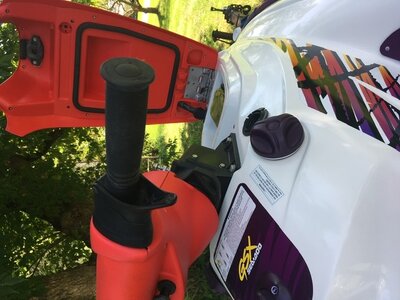

Anyone know of a good place to buy handle bar grips for a 97 GSX? And how to change them? Do they just go on with friction fit or is there a piece in the end of g handle bar th holds them on or do you use an adhesive?. Thank you

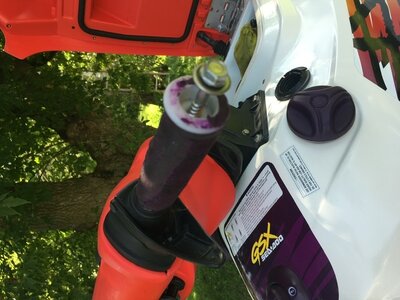

BE2F47E7-0FE3-4CD5-A99C-60D9E4D57005.jpegSo easy to get off, just pry the plug out of the end and remove the 10mm bolt and they pull right off, no adhesive thankfully.Now hopefully someone know where I can get replacement grips that will fit with the original mounting system?
I got OEM ones off ebay, there aren't many choices either.
C083E092-95BD-4439-9388-1B3E8C36F1E5.jpegOh good to hear, I think this 97 may be sold, luckily I had some grips on my 96 that are in perfect condition but now I will need to replace those. Thank you, I will have a look on eBay
