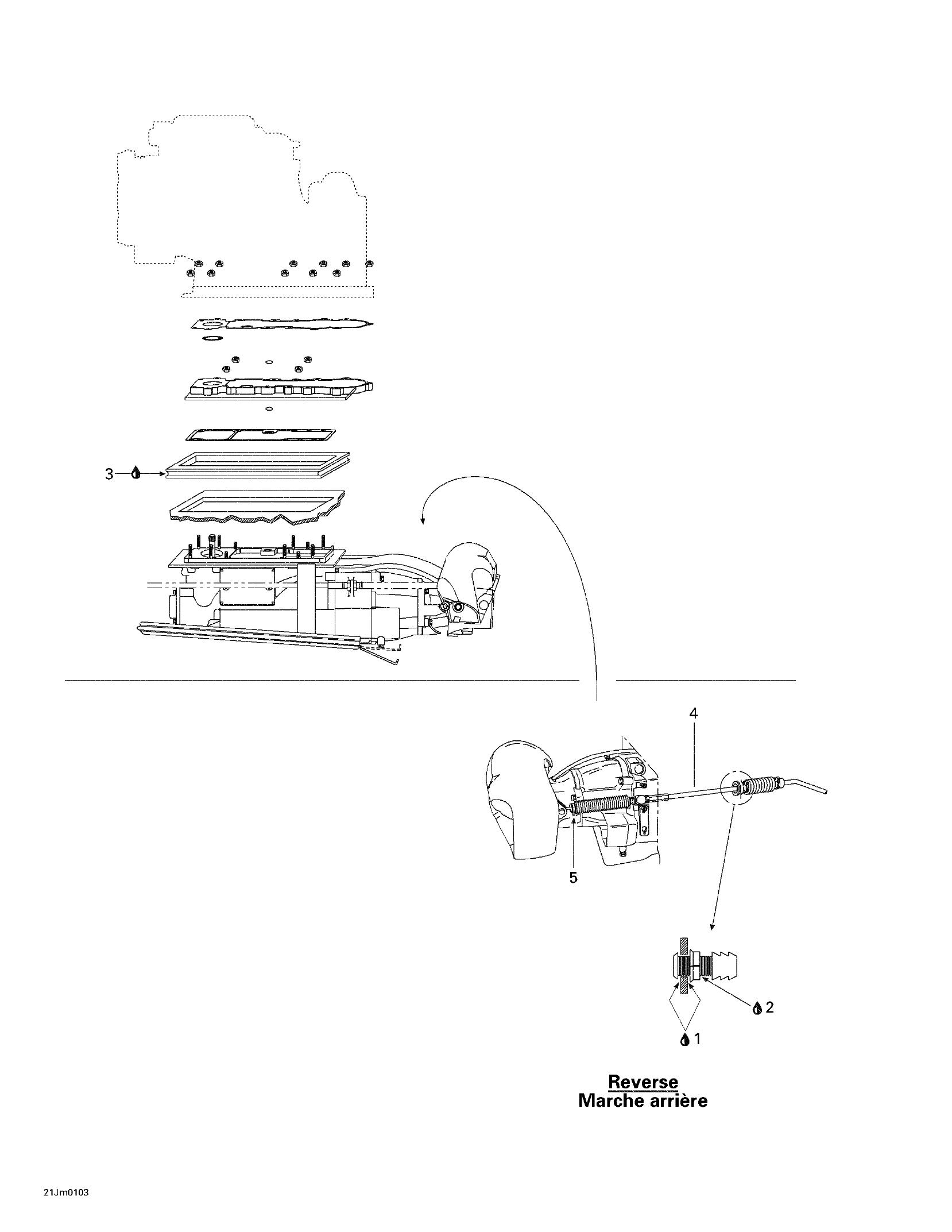

Welcome to the forum. You need 204170135 you can get to the factory microfiche here http://epc.brp.com/SiteMods/BRP_Public/BRP_Public_Login.aspx?ReturnUrl=/Index.aspx Just click the drop down PRODUCTS tab and click on Seadoo Boats and keep click thru to your boat. It is on the Propulsion page.
The google the part# or call your dealer for the cable
Item #4
