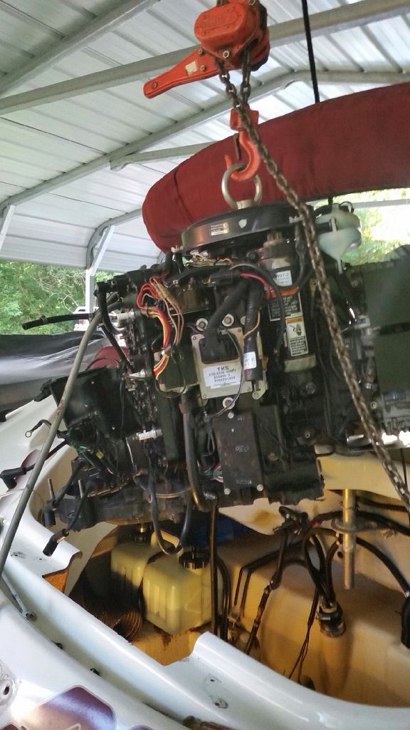

More info to come. Mechanic sent me picture last night.
Yep... that's a Merc engine.
Tell him to closely inspect the surfaces where the gaskets go, and clean them well. The factory gaskets will have an RTV bead on them, and it will seal up small imperfections. BUT, if there is heavy corrosion, stuck on old gasket... or the parts are warped... then they will leak.
Also... if he's not a "Mercury" mechanic... tell him to make sure the O-rings get put in the base plate. (they just set in)
Well.....my 2000 Challenger 1800 engine had to come out in pieces. There's not enough clearance to remove it in one piece.
I found out that last time they attempted to replace the gasket without removing it and just lifting it up far enough to replace the gaskets. That's why it didn't work.

Doc - he is a mercury mechanic but mostly works on outboards. Fishing boats.
Well... I'm glad they got it sealed up for you. And, I'm happy to hear that they confessed that they cut a corner trying to replace it the first time. At least you know the real cause.
Not sure what you meant by the engine had to come out in pieces. I removed and put back my engine in in one piece...and I have the same boat and motor that you do. Its just very difficult to remove exhaust hoses...but once you accomplish that simply raise it far enough to clear mounting studs. Then rotate the engine 90 degrees to clear fiberglass housing cover lift more and you are out.
I'm only telling you what the mercury mechanic told me. Now..... He usually only works on Outboards & fishing boats. He is part owner in a Pheonix dealership.
