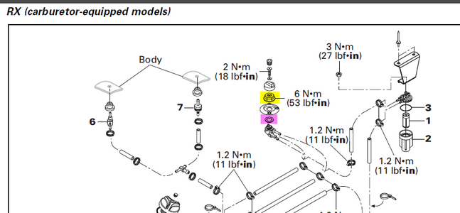

Where would the fuel selector have an air leak from? Looks like the O-ring is on the inside of the hull from this diagram. Even then it appears to be just a seal between the hull and the internal self-contained check valve. I was able to clean it up and make it move from the exterior:
It is inside the valve itself. There is no exploded view on the diagrams because it is considered and unserviceable part.
