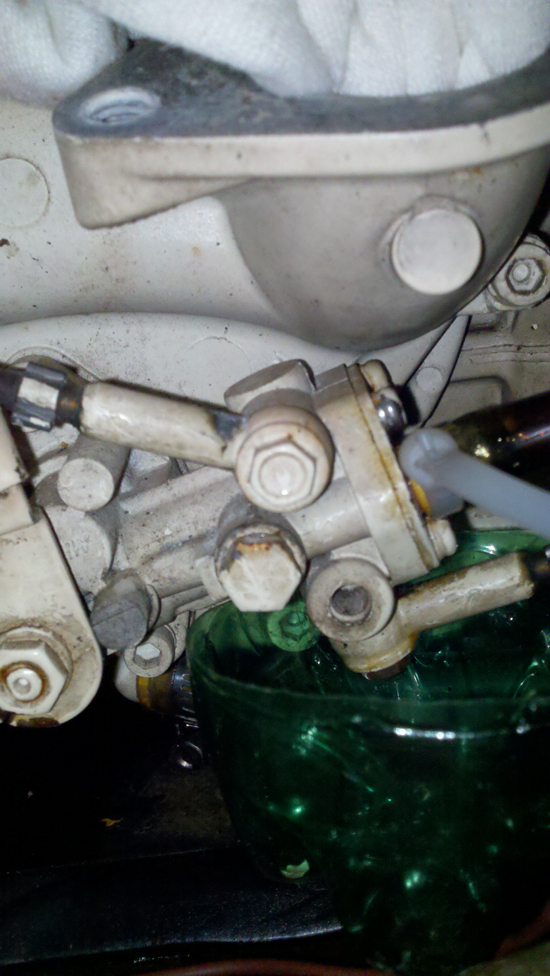

It is straight with The injection supply line thats white zip tied, a hex plug, just to lrft of the tie.
