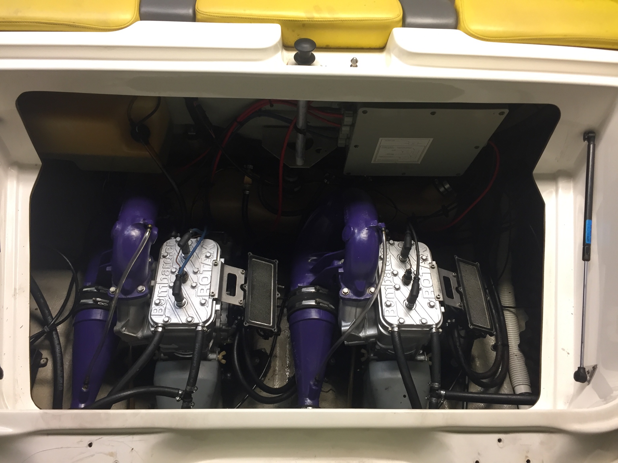

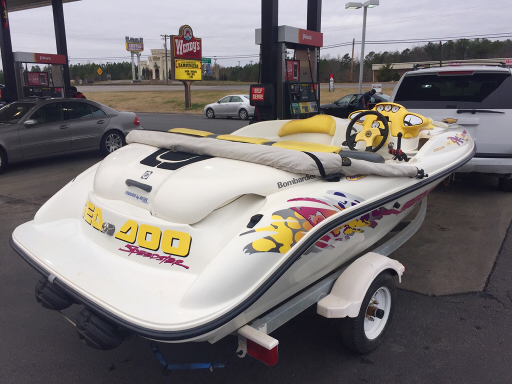

Sold my 97 sportster last summer, had fun in it but it was a tad slow
Found a clean 97 Speedster that needed some work and thought I'd see what having another engine will feel like
Will post more pics as I work on it
One engine needs a rebuild, I got a good used one cheap from a local, so I'll be rebuilding the 3rd for a spare.

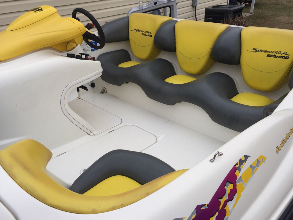

Seats are ok, might let them go one more season

Those seats are as nice as they come. Nicest ones of that style Ive ever seen.

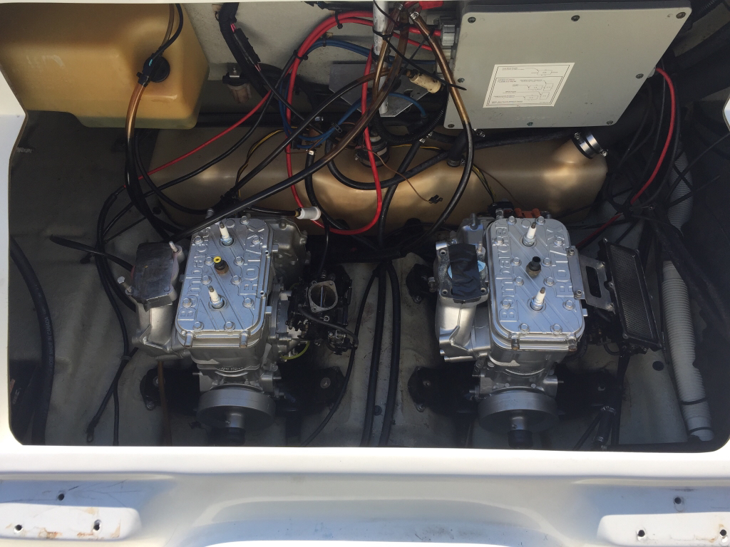

Rebuilt crank in the second engine
Little man giving me a hand
Hope to have everything buttoned up soon

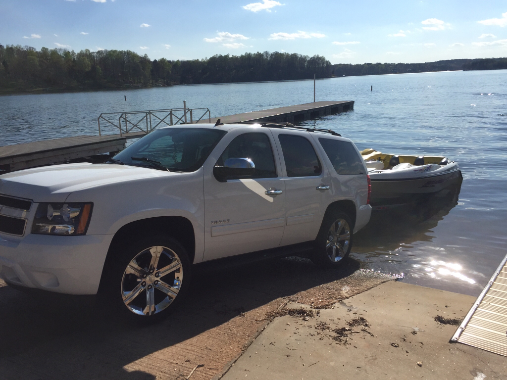

New tow vehicle got some Seadoo treatment

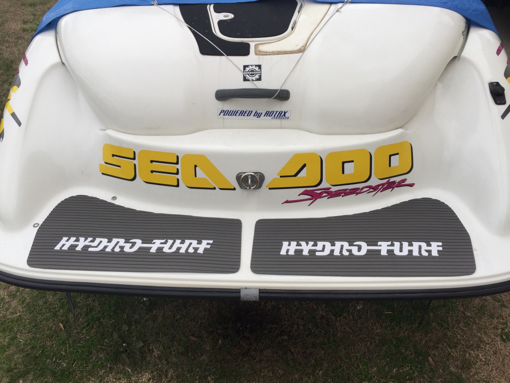

Hydroturf and Trailer wheels came in today
Before
Mocked up, went with the dark gray
Thought about the Elite mats but stuck with HT
Ready for a test start this weekend
