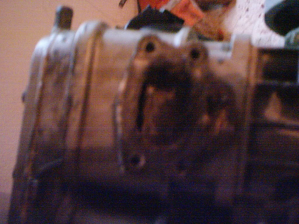

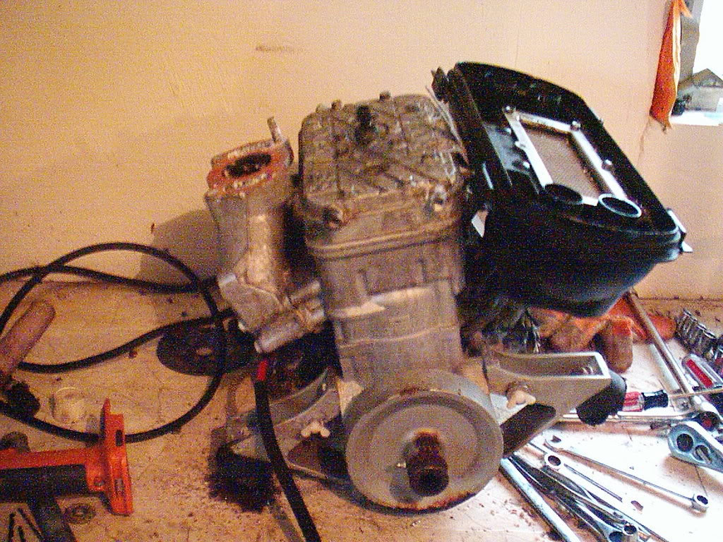

Ok i pulled the motor out of the ski today...the story is that it sunk 2 years ago and just sat. Well there was still water in the motor. It looks great inside. :lols: Im only 17 but I have never seen anything worse then this. I bet the piston is coroded to the cylinder wall. Im not ever sure if its a good core...o well get what I pay for I guess. Heres some pics.
not a great pic but that suspose to be the piston...:ack:
Im thinkin about just finding a motor I can buy without a core and savin this one and possibly trying to rebuild it for a spare....well see. What do you think?
Make this a build thread! I want to see more of what is going on with this project!:cheers:
Yeah, and that motor looks like hell.:ack:

I found a guy that will rebuild it for around $750 and warranty it for a year. The warranty covers everything and I mean everything! If it sunk again or i forgot to put oil in it then its covered. But while I have the motor out anything else I should replace? Im new to wave runners but I think theres a seal, i read in another thred that will burn up if you run the ski for more then 5 min out of the water. Should i replace this while Im at it? And I was going to have a look at the impeller and replace the wear ring also. Thanks for anything. George
