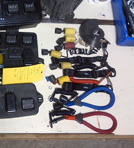

I did the same thing last year, I love the wrist straps, find it alot easier then clipping it to your vest. I had Minnetonka program all my keys and MPEM's last year, now it doesnt matter what key is used for any seadoo. The old style ones are now spares.
Kicker, How many dess keys can each MPEM support.
SDB, if there is a limit, its high enough to not be a factor for a standard user, but maybe nick might chime in on that if he knows.
for those DIY guys, you can make a lanyard out of weed eater line, there are a couple of threads on other sites showing how to make a homemade lanyard by boiling the line around a wooden dowell to make a coil, then attaching the ends to the key & clip, cost would be minimal to do that. can't hotlink it but if you search you'll find it, there was a full thread on it on pwctoday.
Yup sabr is right....a key can be programmed to as many machines you want, but a MPEM can only handle 8 keys total.
As far as replacement teathers...I like to buy the non DESS teathers (or the ones the OP posted), push the floatie back and pry the clamp open. Its not tough. Then you can insert the DESS key directly onto the teather w/o the clip or a key ring.
