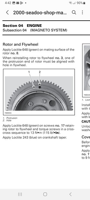

I did not do this procedure, heating flywheel and ring gear with loctite 648 on my 2000 gs 717, no wonder having starting problems with ignition timing. What position should ring be in set inside flywheel
