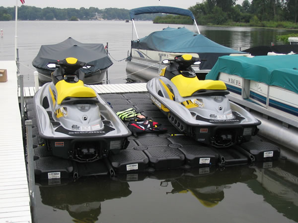

anyone keep there seadoo on a floating dock? id like to buy a pair like this but being in salt water I have to flush after each use so connecting a hose by the rear jet would be pretty impossible expically a 56 and fat :biggrinjester: so how do you do it those that do?
Seadoo makes a flush kit that you cut a hose and put a fitting in and then connect the garden hose under the seat. With that said you could easily do it your self with some stuff from lowes. I would put in a ball valve to shut off the water that would be exiting the hull before entering the engine that way all the flush water goes through the motor and exhaust.
What you can do is,, slice the flush line inside the hull, put a flush adapter in-line and a shut off valve behind the flush adapter. Use the shut off valve when flushing and turn it back to the open position when not flushing as this line need to be OPEN under normal operation. You will need to CAP or PLUG the flush adapter as it would need to be closed during normal operation.
Or, buy extra blocks and make the outer edges longer on the floating dock. This would allow you a place to stand and yet make it no harder to launch and retrieve the ski.
I havnt looked for it but this pic shows it already had a second capped flush port under the seat but there is no shut off valve to close off the rear port
