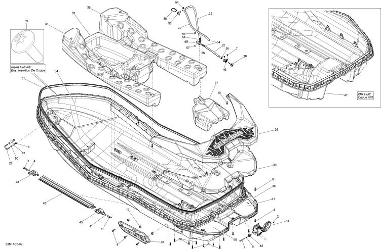

3M panel adhesive 08115. They use it to glue cars back together. Works on Metal, SMC and FRP (Fiber reinforced plastics). Not 100% sure what the "Polytec" is made of that BRP uses on the hulls. You'd probably need to put a backer behind it since you can't really edge glue. You can check our FRP on Wiki if you want to nerd out. My buddy uses the panel adhesive at the body shop he works at. You can glue two pieces of metal together and the metal will fail on either side of the adhesive--it's some gnarly stuff. He glued the new roof panel on his Explorer roll over he bought and about 8 plug welds.
Hull 292001440 $1,666.99
http://www.gearhead.com/can-am-292001440.html#/s/BRP//292001440/1
Part# 34
$2k out of a $6k purchase price seems about right
2k hull, 2k lid, and 2k engine...
