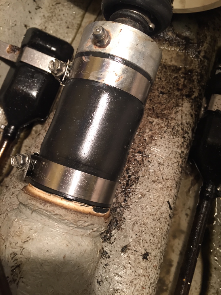

One last thing: - Just looking at the shop manual, it lists "Lubricate drive shaft, lubricate grease fitting at PTO flywheel" as well as "lubricate grease fitting at seal carrier".
The picture in my next post I understand is the driveshaft, I will grease through the "nipple" . Now what about the grease fitting at the PTO Flywheel as well as seal carrier. Where are those located?
Where do I find the grease fitting for PTO flywheel and seal carrier?
In the picture you supplied, it is looking straight up at you. It is called a "Zerc Fitting". Right next to the grey nose extension.
Oops, okay got that part.
My understanding is I need to lubricate 2 things, as per the shop manual: 1) driveshaft at PTO flywheel 2) Grease fitting at seal carrier.
Are these the same thing? Or where do I find the second Zerc Fitting?
it's a "zerc fitting" as well. remove that grey cover, it's underneath on the pto flywheel. you may need to turn the motor by hand to find it.
Noobie, I should have known it was under there. Thank you!
One last question, is that white silicone at the end of the sleeve? Does that need re-filling or does it just look like that from a previous repair?
As long as it doesn't leak you should be fine, I believe that looks factory, can't remember. You can check to see if it moves if you're really concerned, it should NOT move it should be tight to the hull. The most important thing here is the carrier bearing if it seizes it can rip the whole rear (fiberglass) out of the boat. I can't recall but I think that needs checked every ten hrs or so, I looked in the clymers manual but couldn't find it. Seadoo later switched to a carbon ring. The pto boot looks to be full of grease and in good shape as well, squeeze it and you'll know if it needs more or not.
