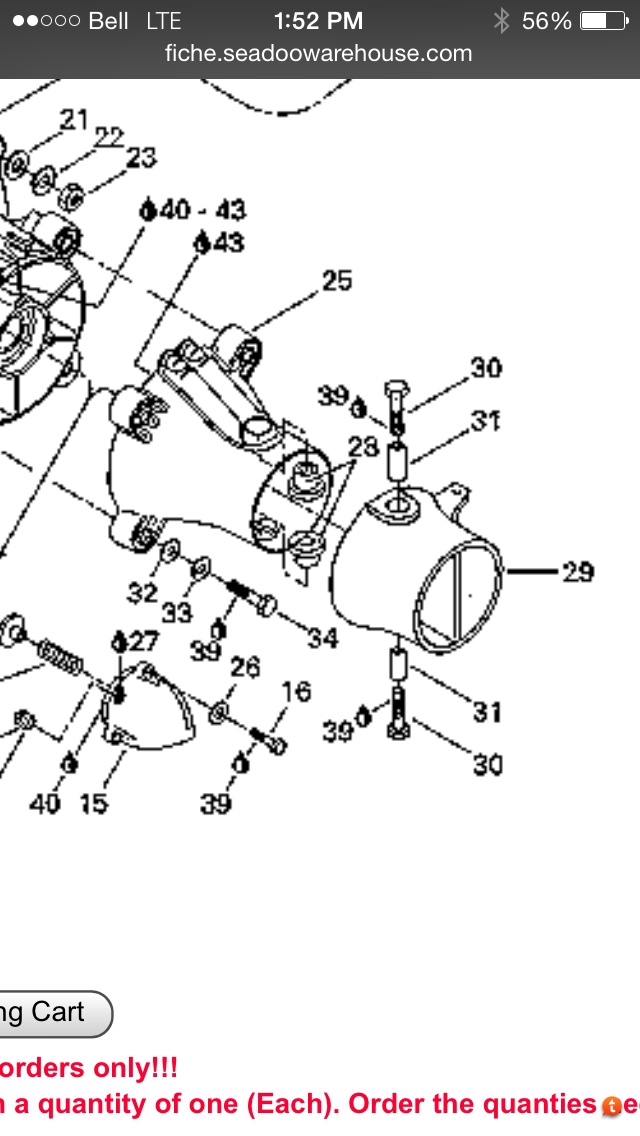

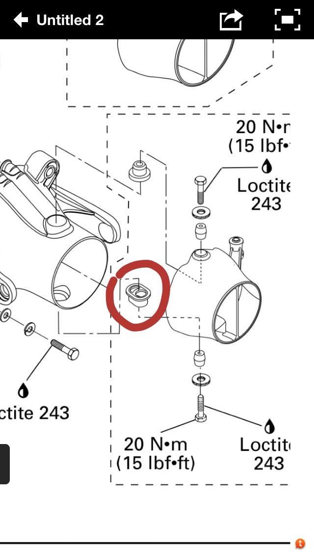

I have a 97 Seadoo Sportster with the single engine, and when I bought it, it refused to plane. The engine runs absolutely perfectly. Touch the ignition and hits on the first spark. When it's cavitating, it pegs the rev limiter too. I replaced the wear ring and foam seal and it still wouldn't plane. I replaced the empeller and if I have my wife walk to the bow it'll plane and run about 38 mph (my phone's gps speed), but refuses to plane easily. I replaced the entire jet pump housing, wear ring again (just in case), foam seal, and it's still doing the exact same thing.
I have no idea what else to try. Help a buddy!
