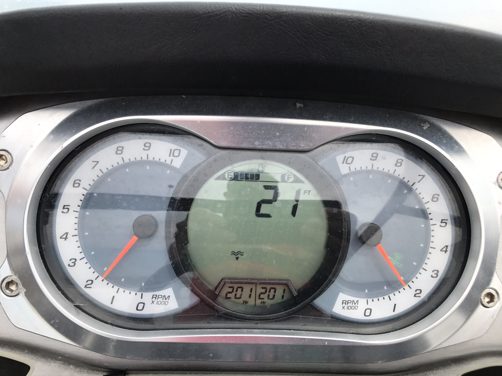

Just for clarification, the starboard hour meter would go away after 30 seconds, like normal, while the port hour meter stays on indefinitely. IMG_2282.JPG
