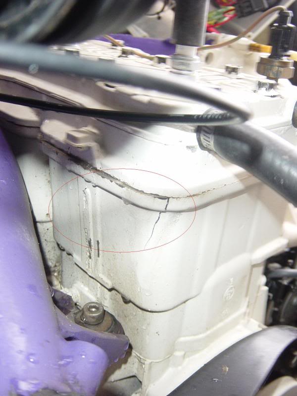

If you have water in the engine... and it got down to 19 deg... then there is a high probability that you split the engine open. If it's going to get below freezing, then you need to drain the water, or add anti-freeze.
Look around your engine and look for this...

If there is damage to the engine... it is reparable, so don't worry too much. Even if you can't see a crack... you will find it as soon as you take it out for it's first ride. The water pressure in the cooling system will find the craks, and spray out.
If it's frozen already... then you need to thaw it out before you can get the anti-freeze in. The heating pad will thaw it in a couple hours... depending how cold it is outside.
