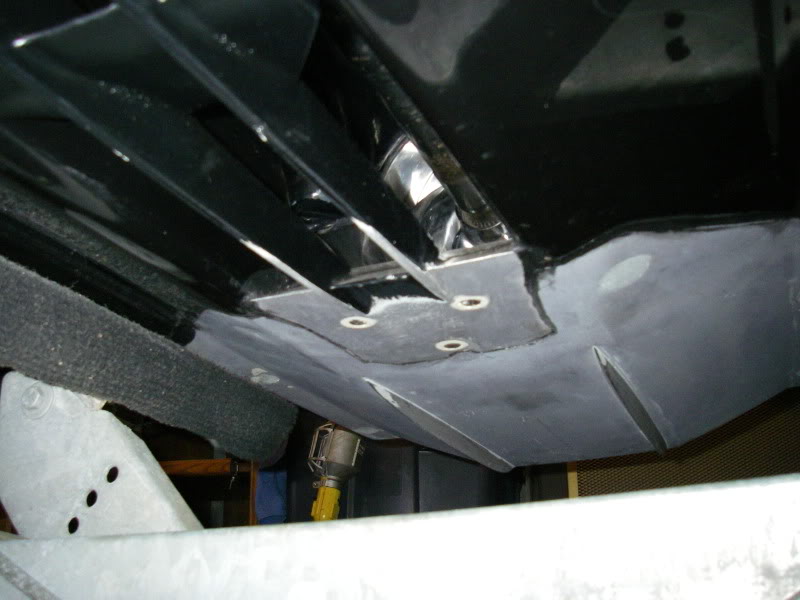

If you really want an rxt to handle like it's on rails...gotta do a ride plate mod....either a new plate or a set of skegs. I installed skegs on my rxt...4-5 years ago?...still there. Let me tell you...you crank the bars at speed...you better mean it....'cause the boat is gonna turn...whether you're ready or not.

I would like to see a picture of the skegs on the RXT, Red2Blue. I think I might want to install that. I run in the ocean in San Diego.

...I would like to see a picture of the skegs on the RXT, Red2Blue. I think I might want to install that. I run in the ocean in San Diego.
The best thing...for me re the ride. Straight line tracking in the chop. You know your boat "bow hunts" from wave to wave...ect. when your course is running diagonally to the waves. You must correct constantly. At the end of the day...you feel it. Skegs makes running through crap much easier. Keep you running straight...till you want to turn.
One thing....you must keep your head on a swivel. Not just for traffic...but the odd "rogue" wave. You lose your balance and come off/launch off a wave...wrong...like maybe...with your bars turned trying to catch your balance?...better hold on...because when the boat lands...and you've got the bars turned....it will turn...(like I've said before...with or without you).
You will not slide the azz of a ski with skegs installed.
aside...when running through chop(nuthin to do with skegs)...at the very least, block your opas up. You don't want to have one hanging down when landing a jump...trust me.
