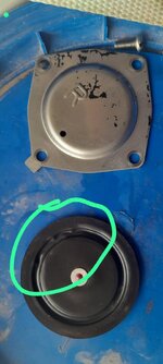

i think that it might be the diaphragm of the second carb that is not pumping fuel. How can i know if the diaphragm is broken?
well, we figured out, it was the diaphragm. we rotate it and started, i'll buy a new one. I have another problem now, there is no fuel in the return hose and sometimes beeing out whater it accelerates by itself . When we took apart the carburetor, we blew through the fuel inlet and the outlet was blocked, so we checked to see if it was clean, and it was. I want to know if there is a pressure valve that should withstand some fuel pressure.
Only place I get carb rebuild kits is from osdparts.com get them back to OEM kits. there is only one fuel pump. I see your boostingfrom the car, make sure the car is not running or you will damage the electrical. Follow Mikidymac’s carb rebuild thread, you can find it on his profile
Don't boost it with a car at all, you can damage the MPEM, ie brain of the ski. Use a low amperage battery tender if you need too, or take it out of the ski.
Glad you found the culprit, I would use the OEM kit.
