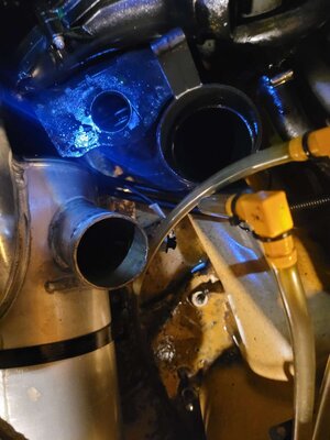

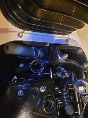

I have a 2010 GTX iS 215 supercharged that went underwater freshwater for about 6 hours the other day. I have it out, drained it, sucked the water out of the valves, out of the dipstick, and I think from any hose that could have had it in there. From the pics does it look like I am missing any? I have 4 qts of oil back in there, at this point do I turn it over, or do I reconnect the hoses first? It does turn over, when I got it out I took out the plugs and spun it a couple times to shoot out the water. Also for cleaning it, do I just hook everything back up and spray? Can I use degreaser?
P.S. I have been reading that the supercharger and intercooler have to be removed and drained, can I get to that water with a flexible tube? Slide it in and suck the water out that way? And then do the 3-4 oil changes, no filter or plugs needed until the end, then run it to burn off any remaining moisture? Sound right or am I missing something? Thanks

That was a helpful read, thank you. So, I did turn it over a couple times while in the water but it never started and only cranked it for a couple of seconds. It lights up fine and turns over fine. Instead of removing the intake manifold I just loosened it and stuck a 1/4" vinyl tube in there and sucked out all the water with a pump. Also removed the big plastic box at the back where the exhaust is, it was dry, the hose had a little water in it, and the muffler was about full, pumped that out, pulled the air box and hoses to the supercharger/intake manifold. I have done a couple oil changes held it at full throttle and cranked it for 5 seconds between each one and pumping the oil/water out from the dipstick tube. It is coming out clear oil now.

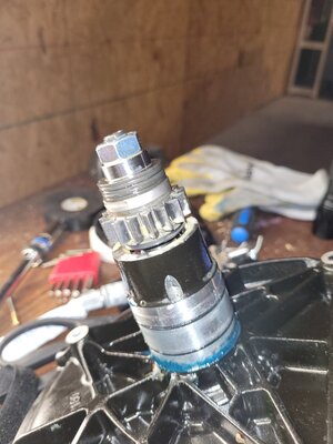

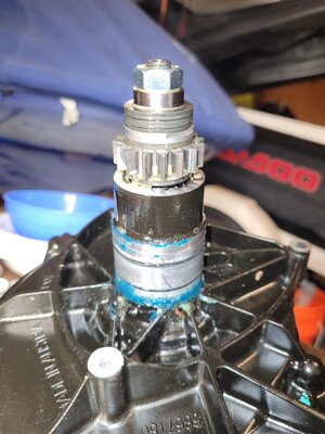

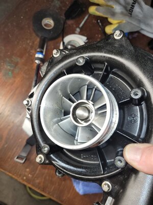

Thank you so much for the advice, I did pull the sc, pics below, from what I can see it looks good, really don't want to open it up if I don't have to. But other than that I think I am ready to put it in and find out what was leaking. I am curious about the exhaust pressure part of it though. With the hole in the back jet pump area for the exhaust that is underwater, and as you mentioned the exhaust pressure would push any out when I start it, so that pressure keeps water from coming in and flooding the ski, but what about when it is turned off, is that pressure still holding the water back? Is it possible that with the hose from the sc to the intake not being connected that there wasn't enough pressure to hold the water back? And I did wipe it down after I took the pics, just thought it would be good to show it exactly as it came out, and when I pulled it and tipped it upside down, maybe a Tbs. of watery oil came out. 20240612_172438-min.jpg20240612_172450-min.jpg20240612_172636-min.jpg
