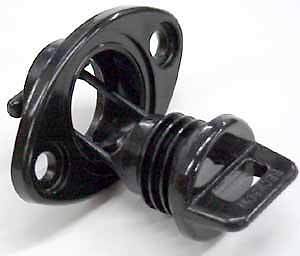

this is what the standard plug looks like (I have no idea what year or model ski you have)
maybe you need to take a pic of the 2nd set of plugs, perhaps you have a set of blowsin type installed < they replace the standard plugs although i'm not a fan personally.

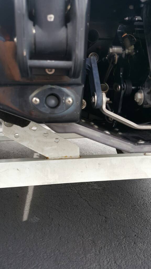

So this is what the plug looks like.... There is a white marble with no plug.... It was sold to like that. When will there ever be a time that I would unscrew this plug? How will I know when it's a good time to unscrew and drain?
You can go to any hrdware store and buy brass end caps that will work just as well as the plastic ones.

re: the pic, that looks different than what i'm used to seeing.
Can anybody else identify that brand/type of scupper plug?
