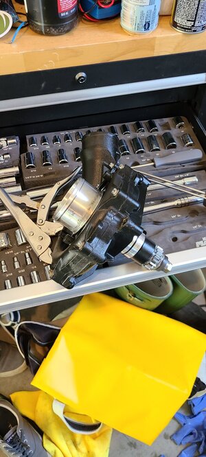

My first inspection at 62 hours.
The SC pulled out after failure.

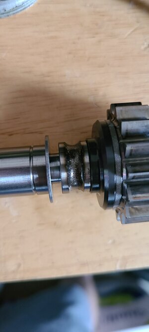

The inner raceway of the failed bearing (Gear Side)
The result of the failure. All fingers and bearings accounted for from the raceway. (Got Lucky)
