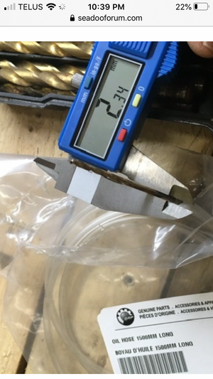

The zip tie was still on the line leads me to also think that the line you used was to large, I use the OEM line and it’s very difficult to get it on the nipples. Once it’s on there I bet you wouldn’t even need a zip tie to hold it in place ( always use a zip tie or another mechanism to hold it ).
926039C1-15C2-4352-86BE-6F8127657291.pngTo verify the ID measurement of the hose is correct I inserted a drill bit into the hose, one that just fits snug and then measured the drill bit.
