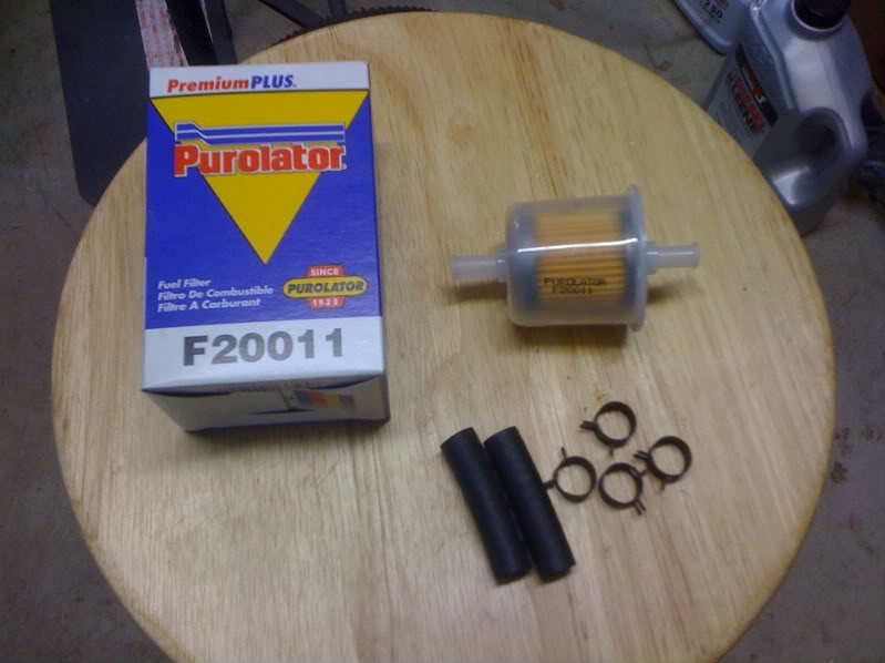

Hey guys, so heres the deal. After picking up a 99XPL a few weeks ago I have been sorting out some issues. After a new wear ring, jet pump rebuild, carb rebuild, replaced all fuel lines, new fuel filter, cleaned baffle, cleaned raves, and cleaned fuel selector, the ski ran awesome. Great acceleration and top speed of around 64 on the GPS. Today, some issues arose. It began showing signs of clogged carbs. Idled rough, and wouldn't rev above 5k. I unscrewed the brand new fuel filter to find that there was a decent amount of dirt floating around in it. My suspicion is that some of this made it through the strainer and clogged the internal fuel filters. The only thing is I can't figure out where the dirt is coming from. I had found dirt in the old fuel filter that reappeared a couple times. The tank appears clean and there is no dirt in the screen on the baffle. My current working theory is that the fuel selector is breaking down and the dirt I'm seeing is parts of the internals of the selector. Is this possible? On a side note, has anyone ever run any other sort of fuel filter? My plan is to bypass the fuel selector and run a filter to prevent the carbs from getting clogged again. I was a little concerned with restriction causing it to run lean. The filter I was planning to use is a 50hp Honda outboard filter. Any thoughts?
