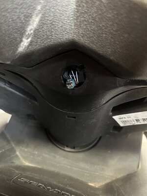

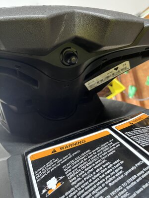

Hello all. Just got my hands on a new to me 2015 Seadoo GTR 215 and excited to ride it. Previously had an 04 RXP and 06 Sportster 215.
I got a deal on the machine because it required a little repair. The post that holds the key (it has the claw key that is new to me) has broken off on the previous owner. He had jammed it in and the magnets connected enough for him to be able to ride, but I’d like to get it replaced. I just cannot find the part number for it anywhere to order it.
I’ve attached a couple of pictures for reference. If anyone could assist that would be great.

Thank you! Ordering that now. Is that something easy to replace? I’m trying to find a video of how to get into that panel but have come up empty. Dealership wants $300 to replace it but it’s a 4 week wait as season is just opening up here in Ontario..
I am guessing it should not be difficult to gain access to it. I don't have the Seadoo out of storage yet to look at it. If I do go get it, I will have a look.
I made the mistake of ordering one off Amazon, idk how your harness is but I had to rig the one purchased, it didn't work out so well. I then ordered one from OSD, his has all the pins and bullets installed where as what I first got was just the post with 4 wires.
The part I gave you is for the complete DESS module. It plugs into the harness.
Yep, picked it up after work from a local store. A couple clips to take off the piece where it sits in and plug and play replaced. 20 minutes later and new one is in! Thanks for this
