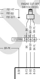

Correct, no programming for the post. Did you use the correct post? There are 3 wire and 4 wire versions.
Screenshot 2023-12-26 at 08.40.15.pngSo the 2011 Shop Manual shows it as a three wire, the correct OEM part #278002325 comes in both 3 and 4 wire versions on eBay. Thats a little confusing. Your ski should power up pressing the start button without the key on the post. Earlier models would power up with just the key on the post. Convoluted to say the least.

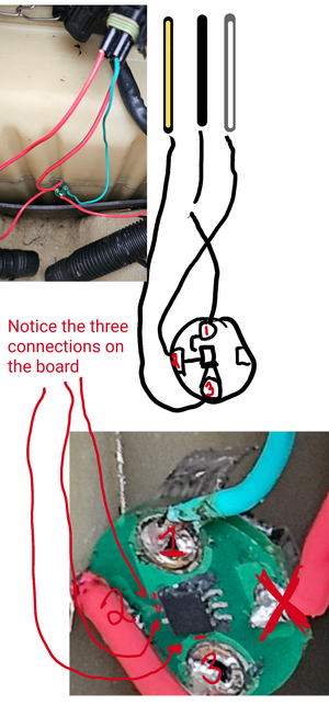

97 Seadoo gsi owned 3 years and burnt myself out with the terrible dess key issues.
This evening I finally took time to figure out how to wire in my dess key permanently and also wired in a generic marine kill switch and lanyard (needs to be normally open). Everything works perfectly gauges/start/stop/beeps/etc.
$20 for the safety kill switch and lanyard. No other purchases necessary.
If interested I'll send out my doodle diagram or photos.
Here's what I did. Then, just use a N.O. kill and put between number 1 and solid black wire. When the lanyard is pulled, it will open the circuit by removing that ground signal. Cheers.
