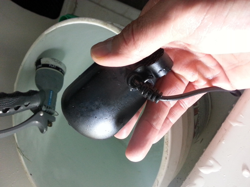

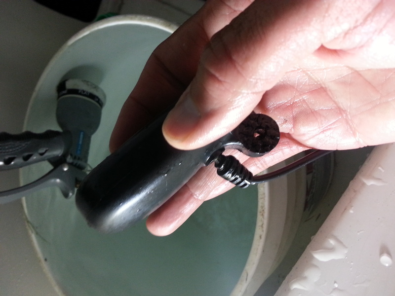

OK so I just went outside and the sensor easily just popped off the bottom and I cleaned it all up and tested it in a bucket of water. You can definitely hear it clicking away in the water and as I turn it around in the bucket, the gauge shows 4.2 to 5.8. Now on the gauge you can set the sensitivity, so I am wondering if maybe my brother accidentally changed it and that's causing an issue. It is currently set to 3, and if I bump it up to 5, the same moving around the bucket business shows 6 feet to 8.8 feet. What should the sensitivity be set to?
Also, here are some pics and one thing I noticed is that the soft plastic base of the wire that allows the wire to flex has broken away from the sensor housing and is loose on the wire. Could this allow water in the sensor and damage it or something? See the attached photos for what I mean:
