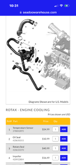

I blew a coolant hose & my '21 GTI SE 130 which overheated & I had to drive it longer than I should have to get to help & also out of the super rough river.
So we ended up fixing the hose and thought all was good until I realized the coolant was still leaking. The ski had absolutely no performance issues until it ran out of coolant. I was scared a head gasket blew or I cracked the block, luckily no water was in the oil and that was ruled out. I let the ski sit as soon as I realized what was happening & started troubleshooting. Still no water in the ski. My ski sits on a lift off my pier normally, so I finally took it to someone to look at. He said it was the water pump housing so I let him repair it. He claims its still leaking even while just sitting off, but water is now in the ski under the engine everywhere. When I took it to him it had never had water inside. He is now trying to say that the PTO Cover/ Drive/Timing assembly is cracked which is a much more involved repair so it would be like $3000.
I decided to trust my gut & take it home since it was not leaking in the ski but now he claims it is still leaking actually worse by the look of it than before I brought it to him. I filled it with water instead of wasting coolant to see it leaks just sitting like he says. So far no leak detected and It has been sitting overnight the inside of the ski is dry. I plan on running it a bit to see if I can see if it's leaking while its on. But could a cracked PTO or Drive/timing assembly be causing the leak? Or does anyone have any insight? I also put something under the ride plate to see if it was leaking from the ride plate.
