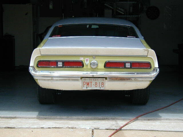

They make inline switches that you can mount and switch off the battery when not in use. I have one on the back of my car for a kill switch...just to the left of the fuel cap.
They make them for marine use as well. They will stop ALL drain on the battery, and no fear of setting off a spark near the gas tank when rehooking the wires.
