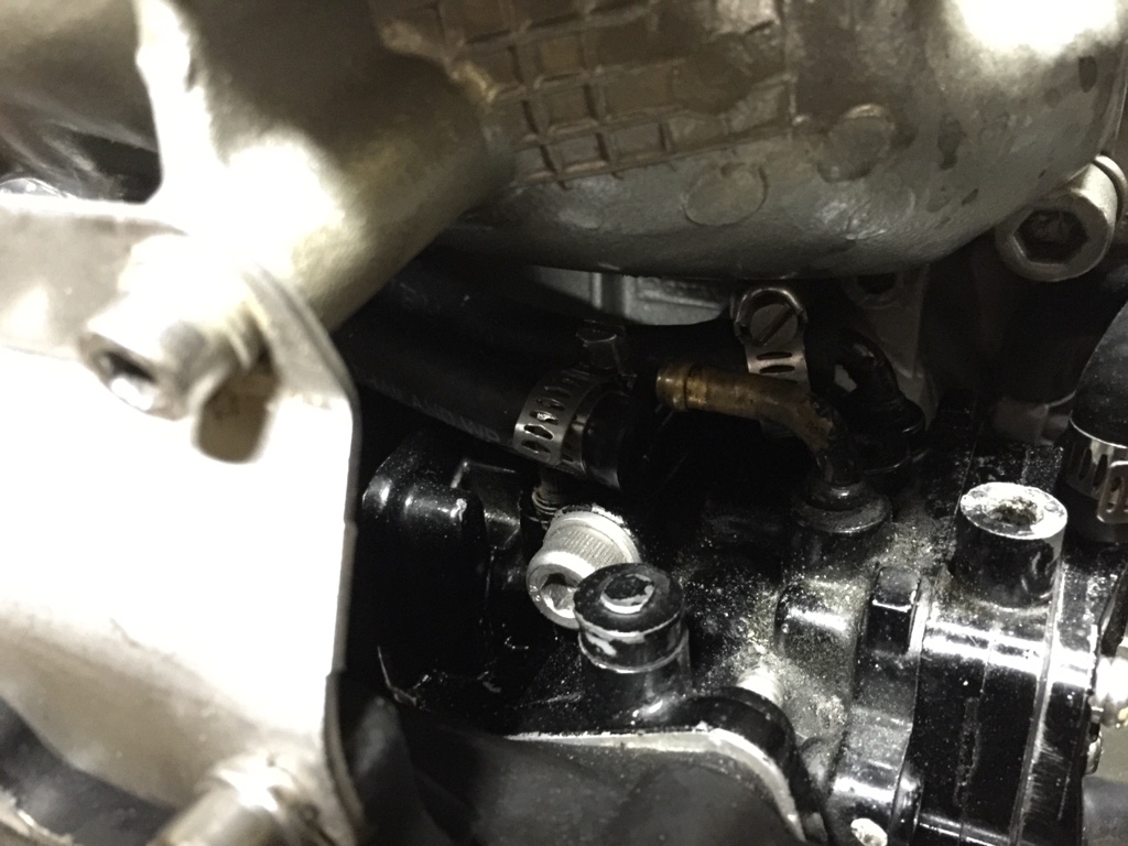

So yesterday afternoon I got the ski pulled off the trailer and onto the stand in my shop.
After letting things cool off outside I went back out to pull the carbs so I could verify by settings.
When I lifted the seat I was hit with a strong gas smell, I continued to pull the airbox and take a look at the HS adjustment needles. What I found surprised me.
Apparently the MAG side carb return line had become detached from the nipple (possibly on a jump) and was leaking fuel. I guess it would be possible that this would limit the fuel available to the engine at high RPM causing my problem. I re attached and double checked everything and will go out and give it a test run tonight hopefully.
