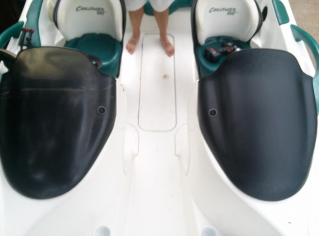

My windshields aren't looking so good, bad faded and bubble looking spots on them. So I got some carbon fiber vinyl wrap and wrapped them... WOW! It looks better than brand new! I did a little searching and didn't find any tips on that, so I thought I would post this up. For $30 if it only lasts a couple of seasons I will wrap them again.

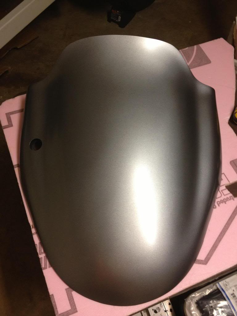

I just prepped and painted ours, it`s still looking good...

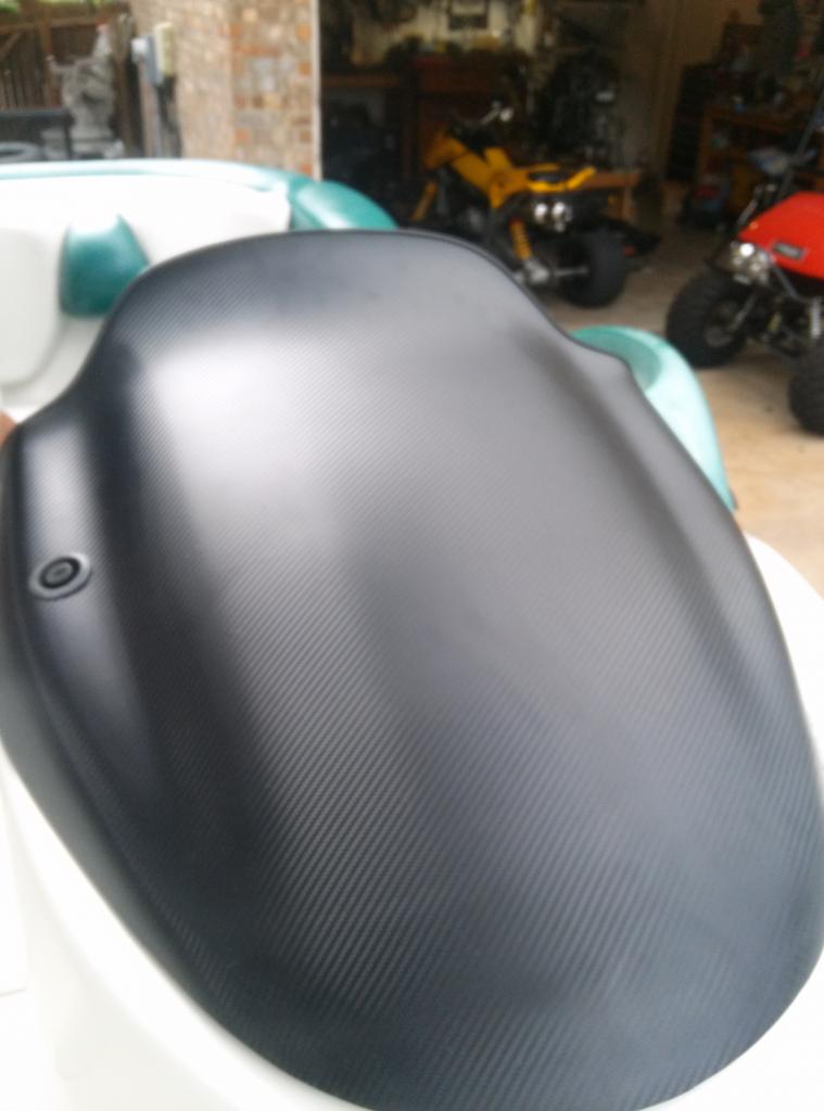

Here are some pictures of it with my phone, I was thinking about painting it, but wrapping was probably easier for me, plus the carbon fiber look gave it some pop!

That came out great!

I think I got mine off Ebay. It was a cheaper material than I wanted, but it worked out fine, looks great. Looking at doing some dash & throttle trim pieces etc next to match it. You have to use a little heat on it to mold into place.

In reply to jaimecbr900 - I also asked Pale Rider this as his paint job on his looks amazing. He responded with:
Paint:
Rustoleum
Universal advanced formula
Metallic Paint & Primer
any surface any angle
It is the paint bottles that have the angled top.

I guess my follow up question would be how much prep work, if any, was involved in either method. If there are fine scratches on the windshields already, how could you achieve such a smooth finish with paint?
My son did my wrap, but he is no expert, I just bought the material. If he hadn't wrapped them for me, I would have just removed them and had them done. You could actually get pretty elaborate with the graphics if you have them wrapped, but the price goes up quick.
My wife painted this and it turned out really good. Prep was wiping down with denatured alcohol and then spraying a few coats of the paint. She has not added a clear coat at this time.
Lowe's or Home Depot both have it right next to the paint.
And just to be sure.. Any props or good jobs should go to Pale Rider. I just followed his process and am very happy.
