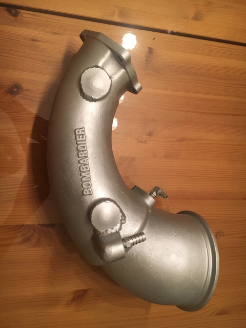

The failed plug diagnosis was 100% on the money. I need to get an extension to reach the allen screws on the foundation and then take it to the welder. He said not to drop it off, but wait for it. I like the way he is thinking. He wanted to see if he could do it in place, but I am not sure he can get his gun in there. He is going to take a drive by today to take a look and see.

I highly recommend you do not weld in place. MPEM's are expensive and hard to find.

Off to the welder in the morning. I am glad I took it off. It looks like a previous owner used a liquid gasket material to seal the upper mating surfaces. The upper water channel was 3/4 filled with red boogers. I think I need to get a new gasket to reinstall the tuned pipe.

UGH... The shop was easy to work with and were cutting out for the day and left the fixed part on a pallet in the yard and just said to drop a check in the drop slot. Know I understand why they didn't want to be there when I picked it up. It looks like a third grader fixed it, all goobers and grinder marks and a few "caves". I could have probably done better. I reinstalled it with a new gasket and copper sealer. Went together nice and smoothly. Dipped it in the river on the trailer. Runs great, but the patch had a slow drip. I called them up and he said "what do you expect me to do for that price?" "We are not know for welding aluminum." Not what their website says or what they said when I asked if they could do the job. What a rip off. I am going to have to JB Weld it for our vacation now, because I have no more free time to fix it right. I am more than a little upset.
