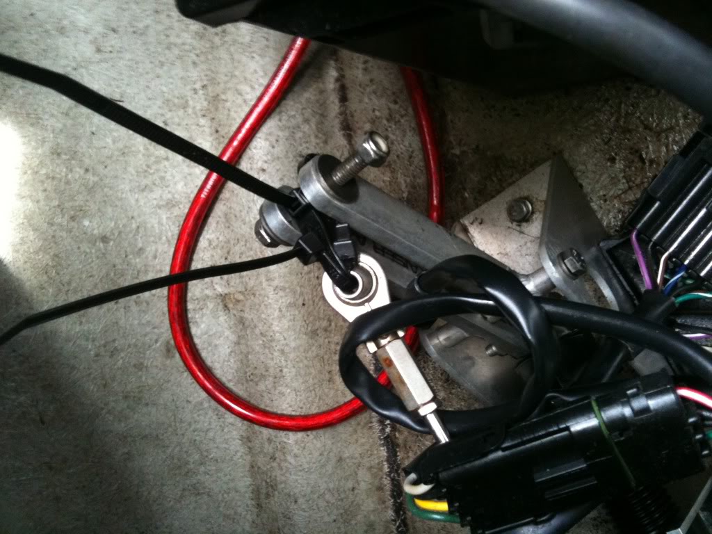

Where is the intake on these things? I look in the engine bay, and nothing looks normal to me. The exhaust goes into a canister, which I thought was the intake. Lol Im bass akwards on this motor. Any more direction would be greatly appreciated :)
What is this for? And why is it zip tied? Lol.
thats for the CIS system. the zip tied part is the cable that goes to the intake grate. the previous owner must have diconnected it and tied it up. it prbably either stopped working or was making the intake grate sag down like most do. deffinatly not somthing to worry about at this stage. your gona have to pull your supercharger off for sure and possibly even your engine to clean out the debris if the washers are exploded.
