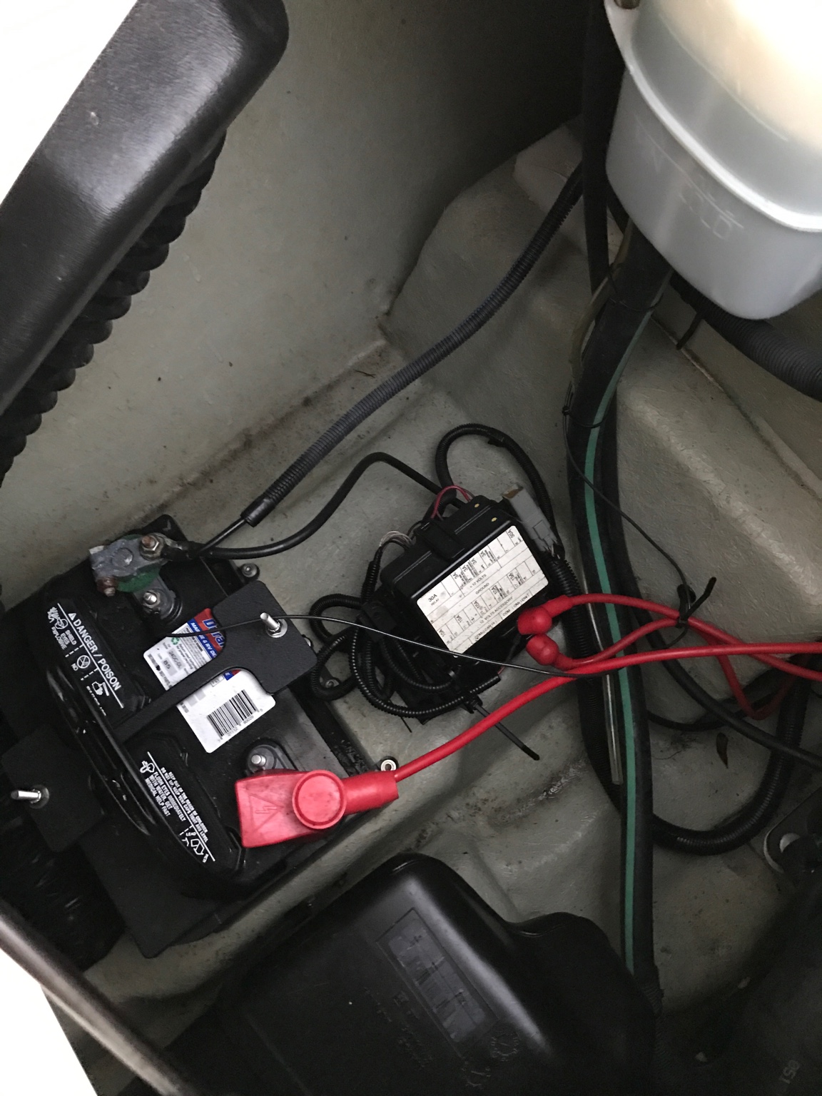

Attached are some pics of where my current battery is, where did you all mount your second battery and if you mounted in front of the current battery where did you relocate the fuse box or that gathering of wires. Thanks for the help. Any pics would be appreciated!
RCguy was it easy to add and do you know what the difference is between and add a battery switch and the 1, 2 and both switch is?
Yes it was easy to install a Perco two battery switch. Just remove the old battery switch and install the new two battery switch in the same location.

No you are not confused. You got it right. A deep cycle battery would be better for your HiFi system. Just top the batteries before you leave for the beach. Buying the kit or seperate parts is up to you. I did not use that West Marine relay or what ever it is? Just don't switch batteries while the engine is rumming.
So my assumption is with the switch I would start it on battery 1 and switch to battery 2 at the beach?
Jeme, I'm sorry to throw a wrench into your confusion, but I respectfully dissagree with rcguy. Using just the switch at the chill spot will work just fine however you could end up with 2 dead batteries if you didnt pay close attention to what you were doing by setting the switch to all on accident. IMHO the blue sea add a battery kit is the proper way to do it but you need to separate basicly every thing except the engines, running lights, and the horn from the starting battery and connect the other draws to the deep cycle "house" battery via a little fuse block, nothin fancy just enough to fuse your stereo, swim lights, etc. The kit is available with a charger and with out, personally I'll be installing the one with the one with the charger in my 2 smoker boat because my stator output is even lower then you guys with timing chains, valves and such, and im gonna add ALOT of stereo. It still comes with a switch for you to turn them on and off and combine them in an emergency. The real benifit is when you are crusing and the starting battery is fully charged the isolator sends power to the house battery charging it, BUT a well discharged battery takes hours to fuly charge. Also the ease of plugging an extension cord into the boat somewhere and walking away is a nice benifit to me, in my boat I have to move life jackets and stuff, then lift the storage tray out and lean down in there to hook up the charger, I would rather just plug it in in a easy to reach spot and go drink beer:cheers: My way is a little harder and more expensive than just a switch but it makes a true dual battery system. Sorry to rant, just some food for thought before you chew on some turkey

The setup I presently use has worked for over three (3) years with no problems. I had the same setup with my 30 foot twin engine Trojan Clean Machine for over 15 years with no problems. I don't disagree with your setup either. There is always a better way to do things but I'm not sure your way is better. I know one thing, it is more expensive.
On second thought, a automatic charging relay maybe a better way to go but it is something else that can go terribly wrong. For me the word "automatic" is a red flag.
Thanks so much. Room is a consideration as you can see from the pics. I wonder if there is some type of quick connect connection for a charger so that I would not have to do the stuff sinkwad mentions.
Thanks to those who posted I appreciate your help. So I am going to need to move my fuse box but noticed it is not screwed down but rather held in by some type of nylon fastener?
Here is a pic of the nylon fastener, also could I mount the fuse box to the side of the engine compartment and could I use through bolts?
