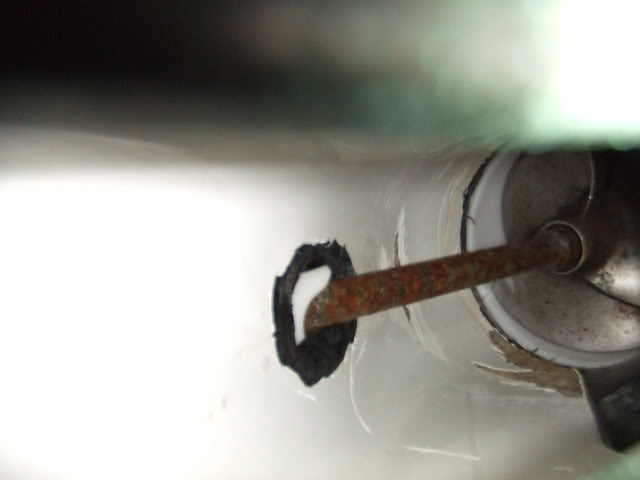

Also, on one engine the prop must have chewed something up and damaged the channel after the grate. Here's a few close ups. I probbaly need to to get in there with some epoxy and smooth out the damage in there. The impellers don't look too bad but I've heard that the Skat Trak 14.5/22.5 is a nice improvement, so I plan on ordering those tomorrow.

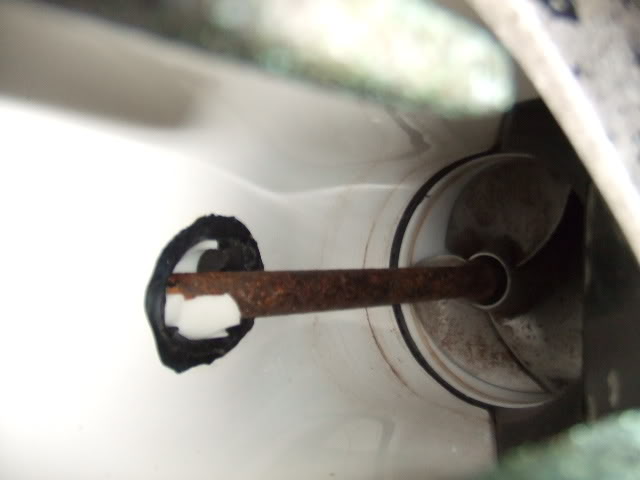

Here's the right side impeller and channel

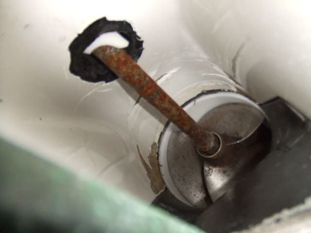

The left isn't as bad
I looks like it could use a little smoothing in that jet pump. Here are the specs for the jet pump wear ring. Wear Ring clearance for your seadoo 1.0 mm or (.040in) Measure the clearance at the center of the impeller blades, with a 12” long gauge. Measure the clearance from the venturi side of the jet pump.

I am not sure on this one. The wear rings look like they may be brand new. The impellers look original but if they do not apair to look damaged the boat should still have a good hole shot. If rpms come up very good on both engines on hole shot and you are haveing cavitation I would look into pump seals and threw hole seals but I am not expecting it to be threw hull seals but I can sure be wrong. It allso looks like pumps may have new sealent on them from when they replaced wear rings. the damage needs to be looked at very well for cracks and so forth and need to be repaired. A good product I like is called marine-tex. It is very strong and comes in white. Read up on it before you use it because there are tricks that you can do to save time and make it look like a profesional did it. If damage was there when new wear rings wear installed I would wonder why they did not fix it. :cheers:
