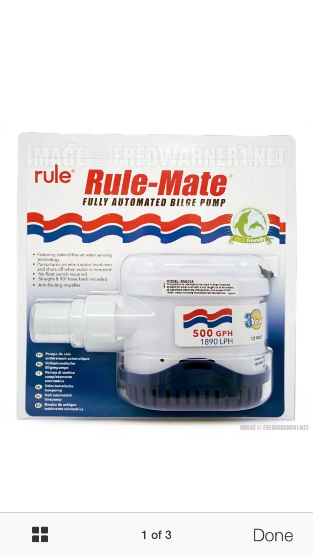

Bilge pump comes on but doesn't pump water out of bilge. Can't see where it is located. Probable causes?
Had the same problem . Mine was coming on but didn't have enough power to push threw tubing so I purchased a new one same make and model and it works now
I think I found it, on the starboard side front of engine. No room at all. These boats are a bitch to work on. Running but not pumping.
