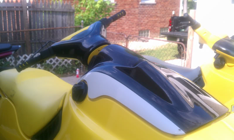

Ok so Im easily amused what can I say. Thanks to this thread I have been smiling for the past hour. I included before and after pics. I used Krylon Fusion for plastic and vinyl! For $4.69 I thought I would give it a shot. I did cover up the seadoo lettering, I dont have a steady hand ha! So far all is well and ready to paint some other faded things lol you guys created a monster! :reddevil: Anyhow, Im amp'd and had to share!:hurray:

The top coat is to help protect the paint from things like UV exposure, chemical/fuel contact etc...While prep is the most important part of the painting process, its also important to protect the paint after you apply it. Otherwise it will fade or get dorked up and you will be back at square one. Its worth the extra time......fo sho!!!

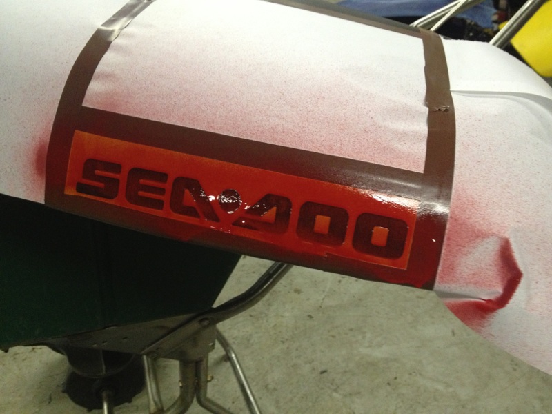

You can also paint logos on your vinyl parts, I wouldnt paint large areas of vinyl but things like this are fine
