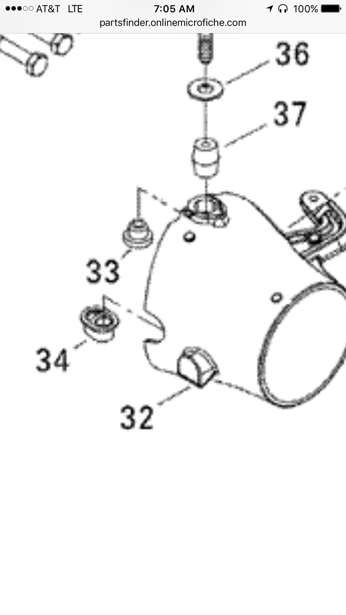

You should check your nozzle bushings (#34 in the pic). You can adjust the angle of the nozzle by rotating it 180 degrees.
You want the bottom rotating point close to the boat so that the nozzle is point down a little more than in the other position.
