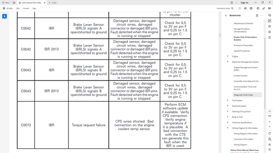

Here is a screenshot of your code.
Thanks Digdog for the reply, I went through the checks on that list, everything has power, no shorts or opens as it says to check, I found a cheap lever switch knowing those rarely fail, still shows the same code. This thing has me baffled. It will lock in forward and will not come out until you take the key off and reset the system, it will then go into reverse/ neutral but as soon as you hit the throttle it will lock in forward and give you the ibr error.
