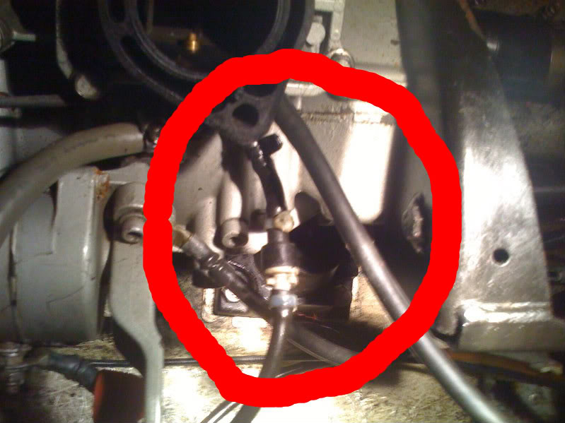

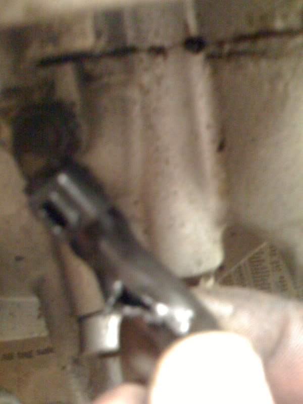

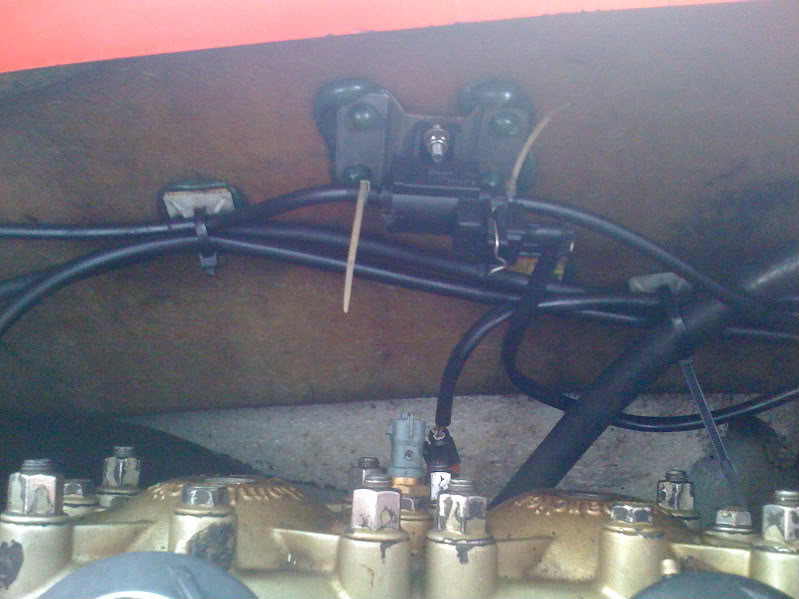

So, when i was pulling it out, i was looking for possible issues, and i found that the two lines on the Rave valves were broken after the tee in the line where it goes into the black box, was broken

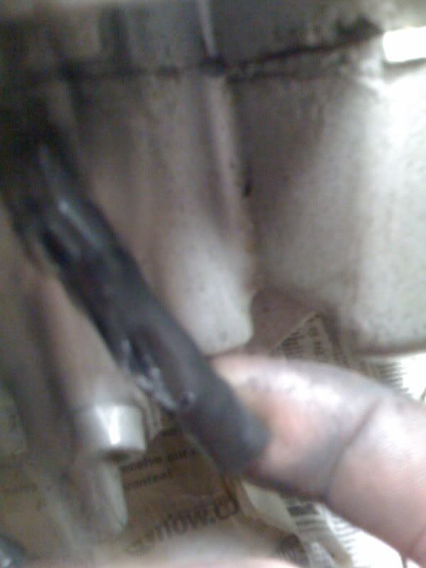

I also noticed that the little black tube thats about 6 inches coming off the motor going into this check valve was ripped out compeletly, almost the whole length. What is this, and could it have caused my problems? I looked and the oil lines are intact still.. no oil leaking out of the little lines coming off the pump. unless maybe the jet in the carb is clogged.. i never thought to check. But heres the little black tube im talking about

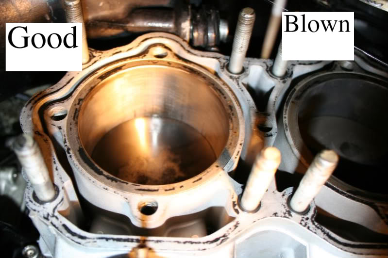

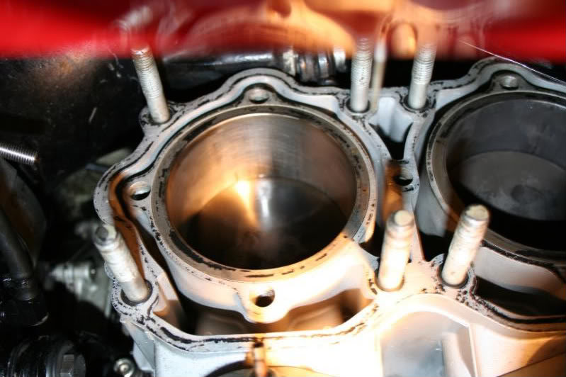

here are some pics of the engine when i opened it up back in sept. i put it back together for the winter without fixing it and now im back to tracking down the problem so i can fix it again.

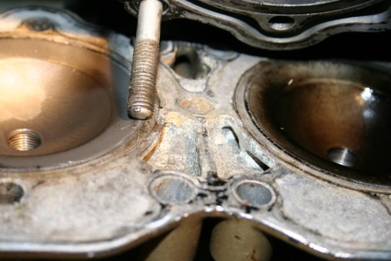

head top piece thing

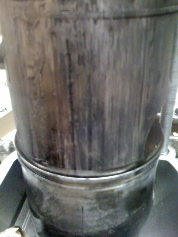

you can see the grey goup im talking about.. what is it and what caused it? Did the broken vacuum line cause it to lean out and bake the ring into the piston? does it look like it lost oil in that cylinder?

I'd say that tube that is not connected to the check valve is the culprit. That line is what supplies the pressure to activate your powervalves and is supplied via pressure in the cases. When the line came off it essentially leaned out the rear cylinder and toasted the cylinder. The additional premix you were running helped to compensate for the lack of lube but when you went to injection only there was not enough oil to prevent damage.
I agree with doc. by the look of your head, both cylinders were smokin hot! I think the grey sludge is unburned fuel/oil mixture(remember it won't burn much without compression) mixed with aluminum dust from your piston or head degradating from the melt down.
you should watch plugs very closely after top end work, they should be very black and possibly foul when you are running twice the oil with no more than half throttle.
I'll be curious to see how purple your rods are from the heat, post pics if you can.

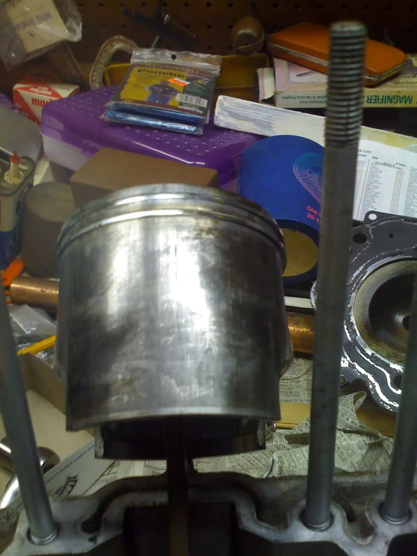

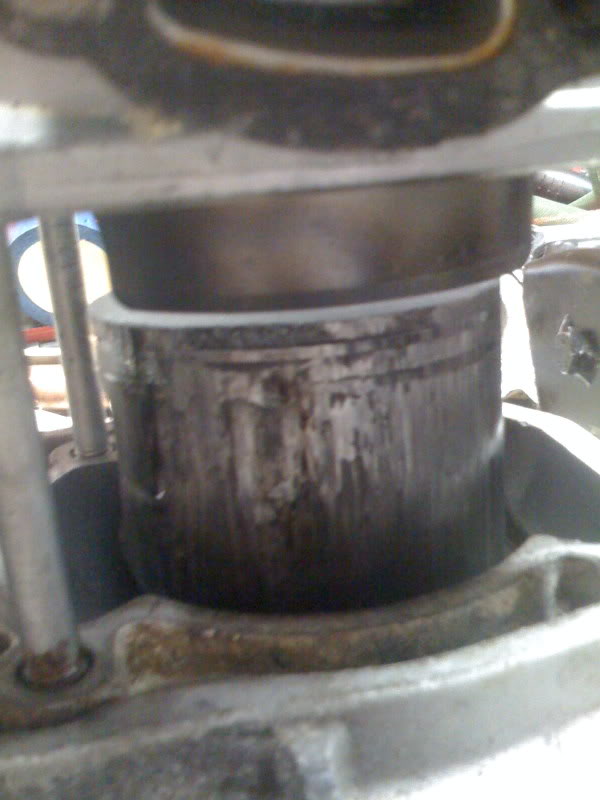

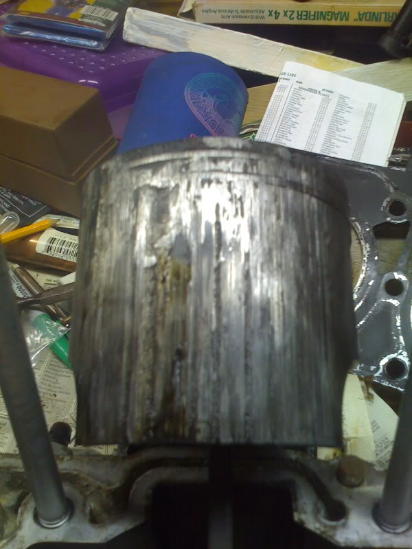

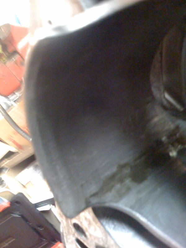

oyyy. looks like its a little worse than i thought. Piston is compeletly destoryed.. looks like the other one wasn't far behind, though the wall and piston look okay. the rings are still loose on the piston and look to be okay on the front cylinder.

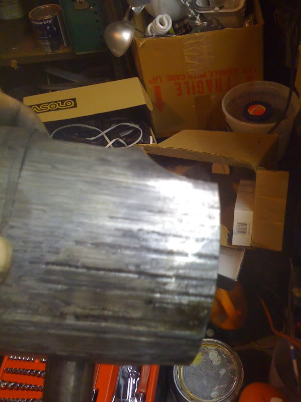

Not so much for the rear cylinder..
so, is it possible this caused it?
and where should i go from here? Cylinders look okay, i think i might be able to save the bad one with a hone?

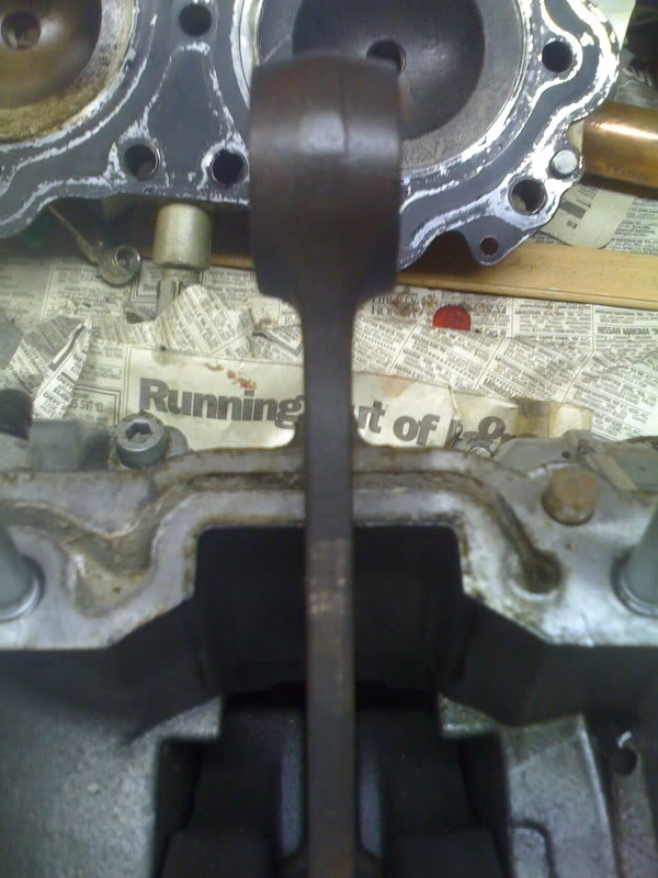

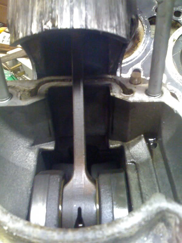

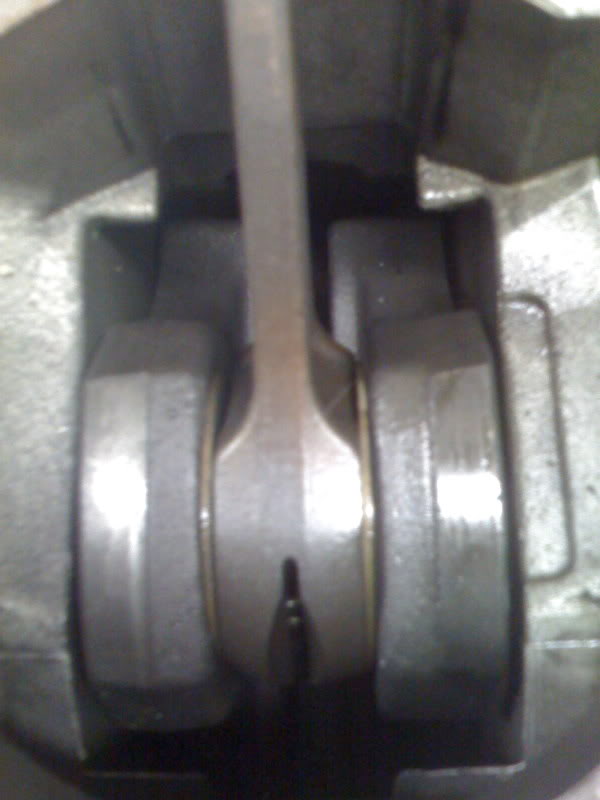

and heres the rod
not discolored actually.. looks good, all the bearings look fresh and okay, nothing burned up or melted down low.

One more thing doc, what do you think about the color of my pistons two post up? Does this tell you anything? The one with less black/carbon was the one with the best plug color and the one that did not loose 5psi compression after the first three hours. Thanks !
