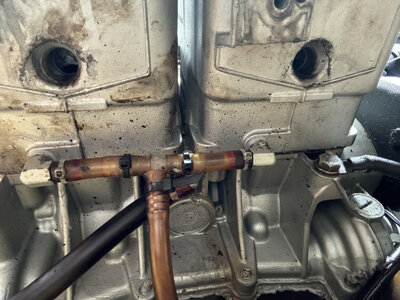

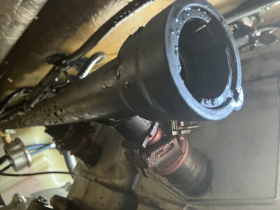

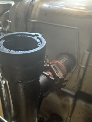

A aepowell New Member May 30, 2024 #1 Has this happened to anyone? Water is coming out around the right hand fuel injector. This is a 2001 GTX. Is there a fix for this? attachments below.
mikidymac Moderator Staff member Moderator May 31, 2024 #3 That is from not winterizing. Only fix is to replace the cylinders.
A aepowell New Member May 31, 2024 #4 I think you are correct. The previous owner said it was winterized when we bought it. He did the right thing and gave us our money back and told us to keep the seadoo.
mikidymac Moderator Staff member Moderator May 31, 2024 #5 Since you have no money into them... JB weld Epoxy Putty?
A aepowell New Member Jun 1, 2024 #6 We have a guy who is going to JB weld it. He says he has had great success doing that.
