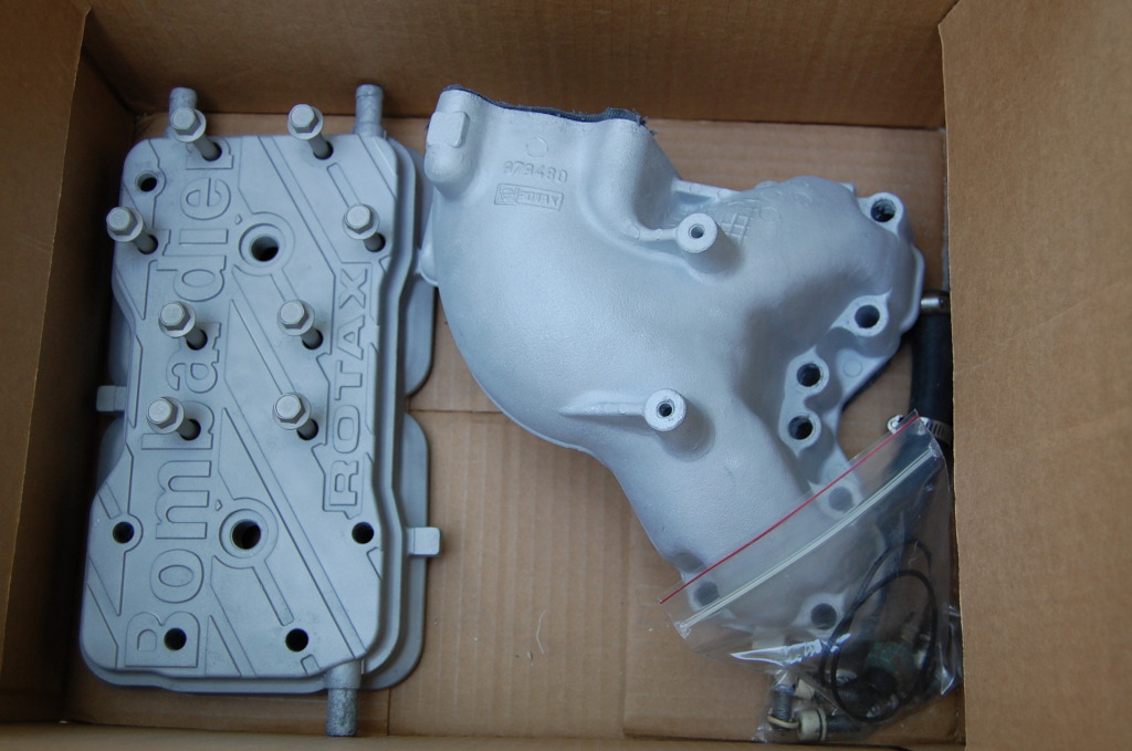

I use G4 media from my local supplier, it's glass bead. The paint Seadoo puts on will stick, ESPECIALLY the silver. I loath the silver engine parts, the white blows off much faster and easier. I have actually thrown silver engine parts to the side and used white ones just to save blast time. Soda blast is IMO for parts that are a bit more delicate, hence why guys use it on cars panels and fiberglass. When using sand on cars and parts it will generate friction and that generates heat. And heat will warp sheetmetal and ruin it and cost thousands more in body work. But the media blasters my buddies use for full restorations use many different medias depending on what they blast. But IIRC most use walnut shells on full body blasts. I think the last time I bought G4 I paid $13 for a 40# bag, always in stock and walking distance from my FIL's shop

Yes, but after a fresh rebuild I notoriously get grease on it and end up slapping the entire engine back in the blaster. It's very nerve racking.....especially when I did it to 1of500's engine I built for his 95.
