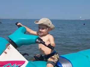

Here are a "Before" and "After" pic of my 95 GTS. Not too bad for a little time and $100 for paint and new decals. It looks like a completely different ski.
BEFORE: (With my son on it. - Sorry this is the only pic I have of it when it was my buddy's)
AFTER:
Stripped all the old decals and removed the rear grab bar.
I used Krylon Fusion Plastic Paint for the hood (sanded down first), grab bar, and handle bar pad.
Cut the large blue vinyl (behind hood & under seat) out of a roll after I made up a template.
Applied the lettering decals that I had made up at a local decal/sign shop.
Re-covered the seat with gray Marine Vinyl.
