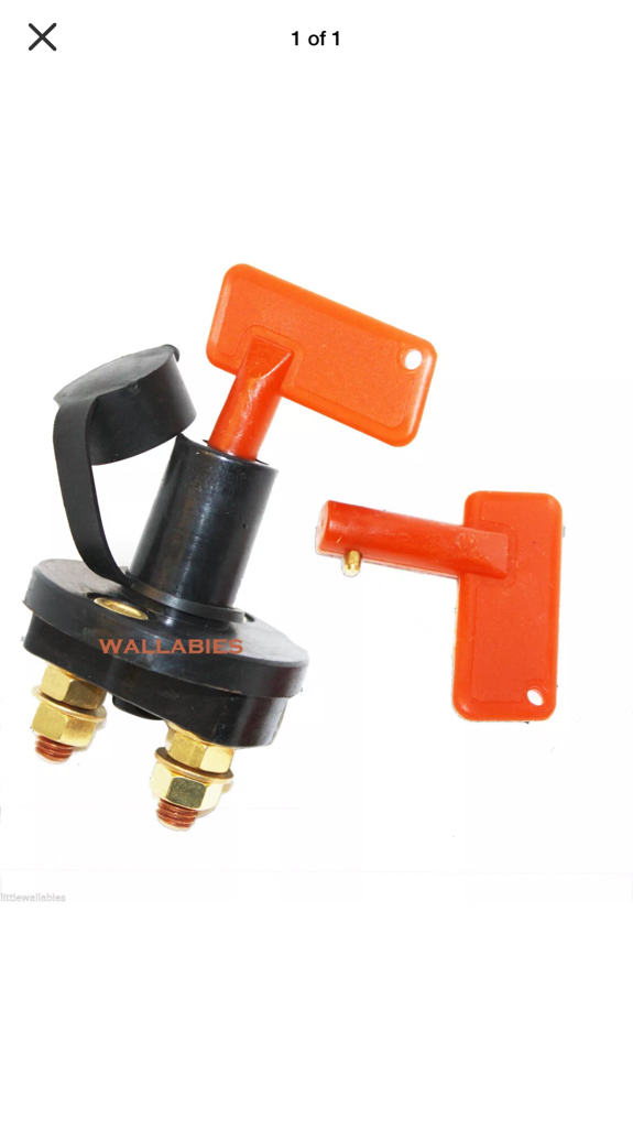

I bought these Battery skill Switches (I have two skis).
And I had [MENTION=41828]Minnetonka4me[/MENTION] make me custom battery cables. Smaller ends for the ski battery and larger where they attach to the kill switch. The cables were 19 inches long and well built.
Find your battery, remove the hot wire and you will have to open the bolt hole a bit to fit the lug of the kill switch. Then install the new cable that Minnie makes from the other kill switch lug and then to the battery. As these are not real heavy, I simply wire tied them to my battery mount bracket.
